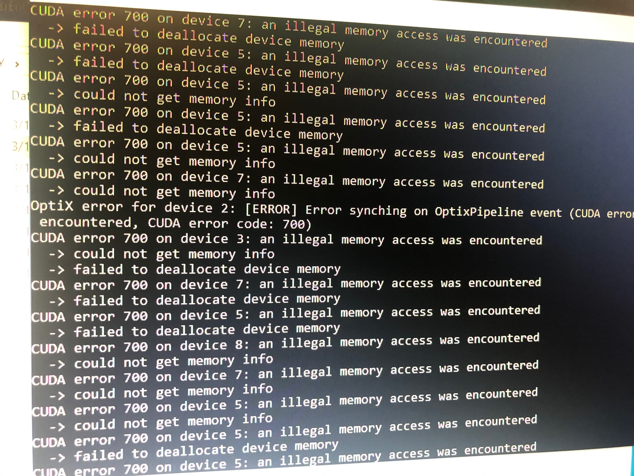

coilbook
Posts: 3167
one of our slaves just crashes when using RC versions. Slave has 2080tis ans titans mixed with cuda error and failing kernels. The slave that has all Rtx cards 2080ti works fine

coilbook wrote:one of our slaves just crashes when using RC versions. Slave has 2080tis ans titans mixed with cuda error and failing kernels. The slave that has all Rtx cards 2080ti works fine
What version do you use and could you please share a scene that reproduces this issue for you? We have addressed an issue causing an error like this in RC4 so it is worth trying if you haven't done so already.

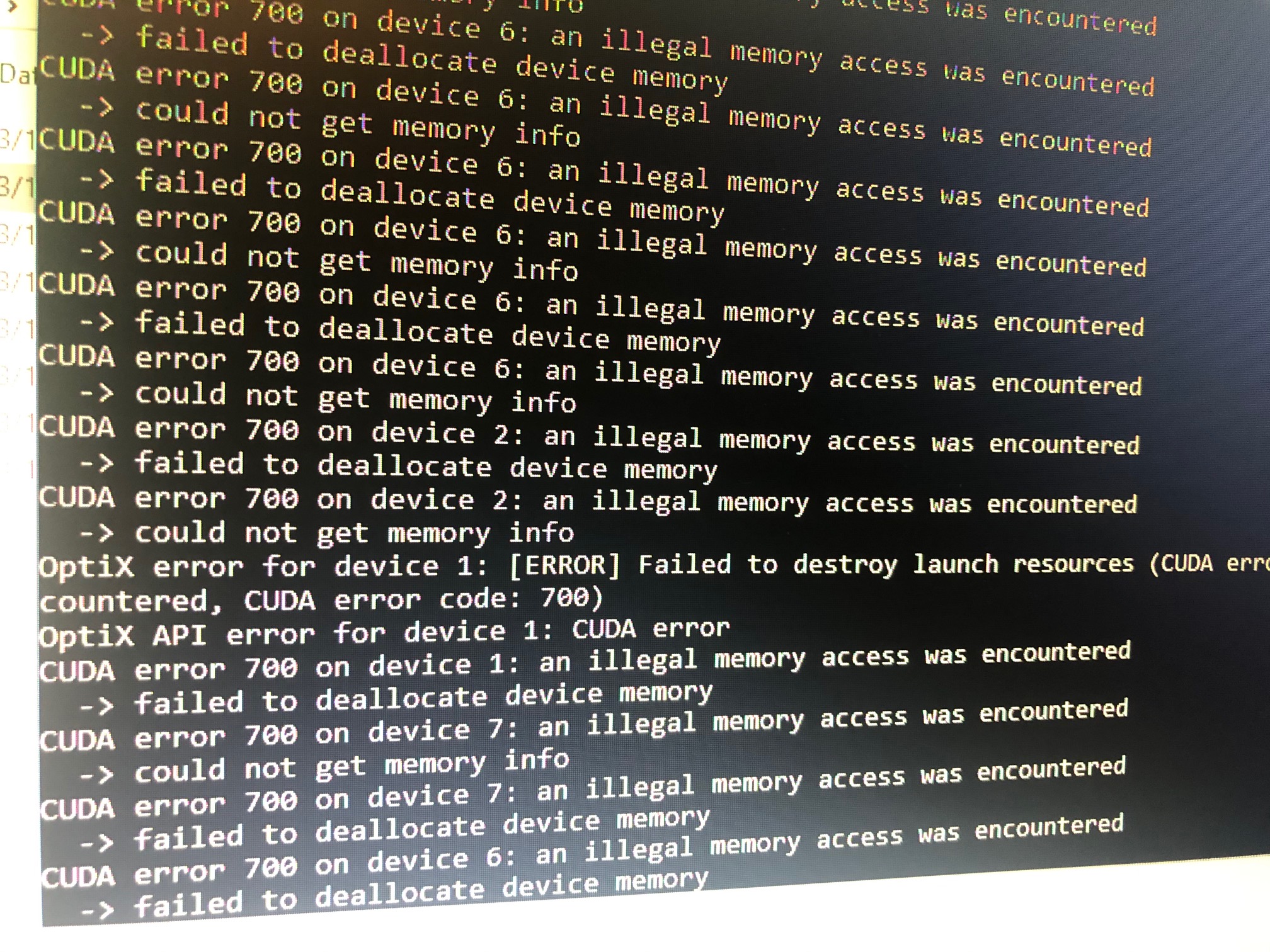

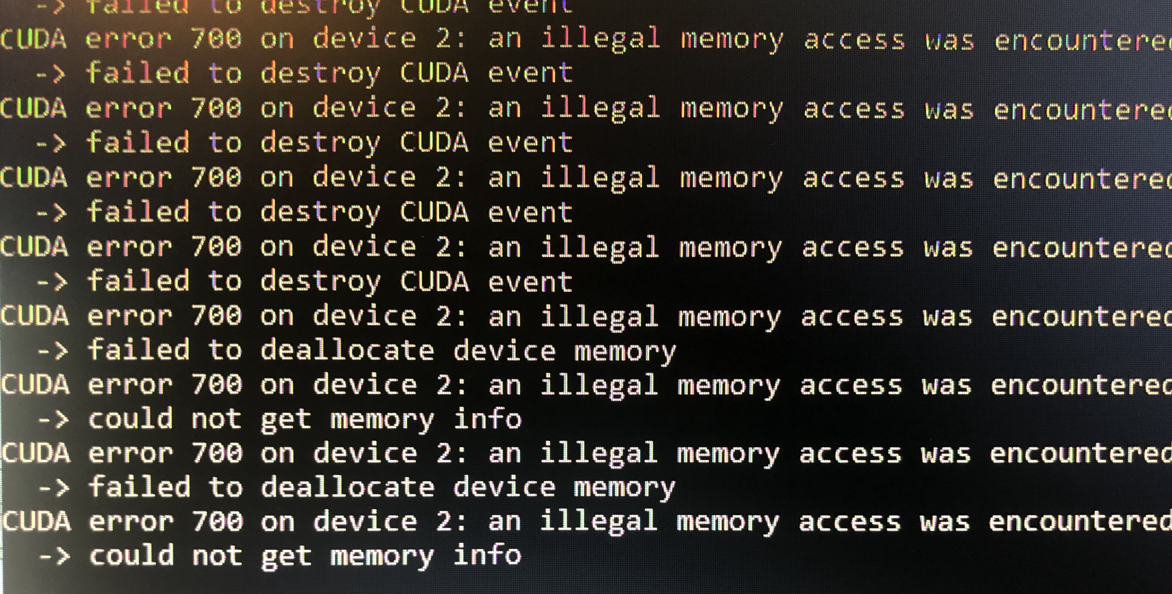

HI
We were using RC2 since max doesnt have RC4. We also get optixpipline error. I will try to send you the scene tomorrow as PM
