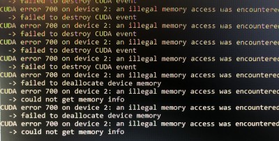

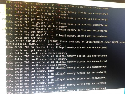

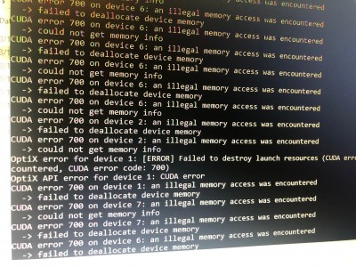

What version do you use and could you please share a scene that reproduces this issue for you? We have addressed an issue causing an error like this in RC4 so it is worth trying if you haven't done so already.coilbook wrote:one of our slaves just crashes when using RC versions. Slave has 2080tis ans titans mixed with cuda error and failing kernels. The slave that has all Rtx cards 2080ti works fine
HImojave wrote:What version do you use and could you please share a scene that reproduces this issue for you? We have addressed an issue causing an error like this in RC4 so it is worth trying if you haven't done so already.coilbook wrote:one of our slaves just crashes when using RC versions. Slave has 2080tis ans titans mixed with cuda error and failing kernels. The slave that has all Rtx cards 2080ti works fine
We were using RC2 since max doesnt have RC4. We also get optixpipline error. I will try to send you the scene tomorrow as PM
We too are getting this memory error with a scene that was previously working in RC1(was disabled today/this weekend). I can't share the ORBX file publicly but I have a dropbox link if I could PM/email it.
GPUs that it fails on 1080/1080ti, quadro RTX 4000, titan RTX, and titan V.
We have RTX OFF.
Ours fails on both centos and windows.
We rolled back to RC2 and this appears to be working correctly for now. Nope RC2 is failing as well... Is there a way to get RC1 back online?
After thinking, this might be a volume issue. 2 weeks ago we had to do some hackery with converting an emissive(fire) VDB to a point cloud to get it to properly light a scene. It'd fail in a similar fashion or simply just stop rendering mid way through. I saw you guys had fixed similar issues in the bug fix notes so we assumed it had been fixed. Up to this point I've been using randomwalk for ALL my volumes since then except for TODAY where I switched to a standard medium. Happy to share ORBx and VDB files just need to send privately.
We have RTX OFF.
Could you please confirm this happens also with RC4 and share any ORBX we can use for testing if that's the case? Thank you.ptunstall wrote:We too are getting this memory error with a scene that was previously working in RC1(was disabled today/this weekend). I can't share the ORBX file publicly but I have a dropbox link if I could PM/email it.
We have RTX OFF.
