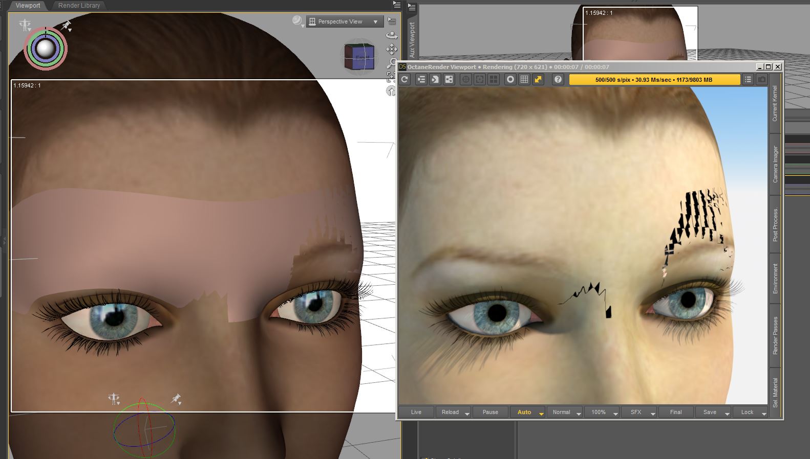

UHF wrote:Rajib. Its not hair. Its V4 colliding with the same V4.
Ah. Sorry, did not notice that.... The line in the forehead I get is generally due to the hair colliding with the head and in any case this happens whenever 2 geometry intersect and expanding one of them so that they don't collide kind of works most of the time. . hmmm... If you can select the Eyebrow mesh of V4 , under the Parameters Tab under the Eyebrow mesh do you see General->OctaneRender ? In that if you change OctaneRender:Visibility control to 0 does it help ?
If possible can you put a screen shot of the scene and parameters tab with the V4 eyebrow selected ? I don't have V4 so unable to check.

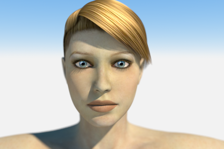

Ok, I downloaded V4.2 and made a render.
V4.2 base character render

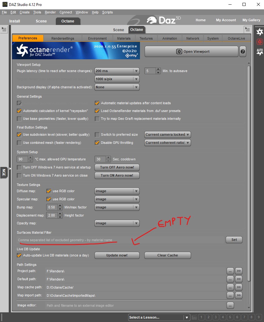

Does this look to you ? There are no artifacts in the forehead. If this is okay, basically under Surfaces Material Filter remove everything and render. No need to set any opacity to 0 etc. Default Visible off works.

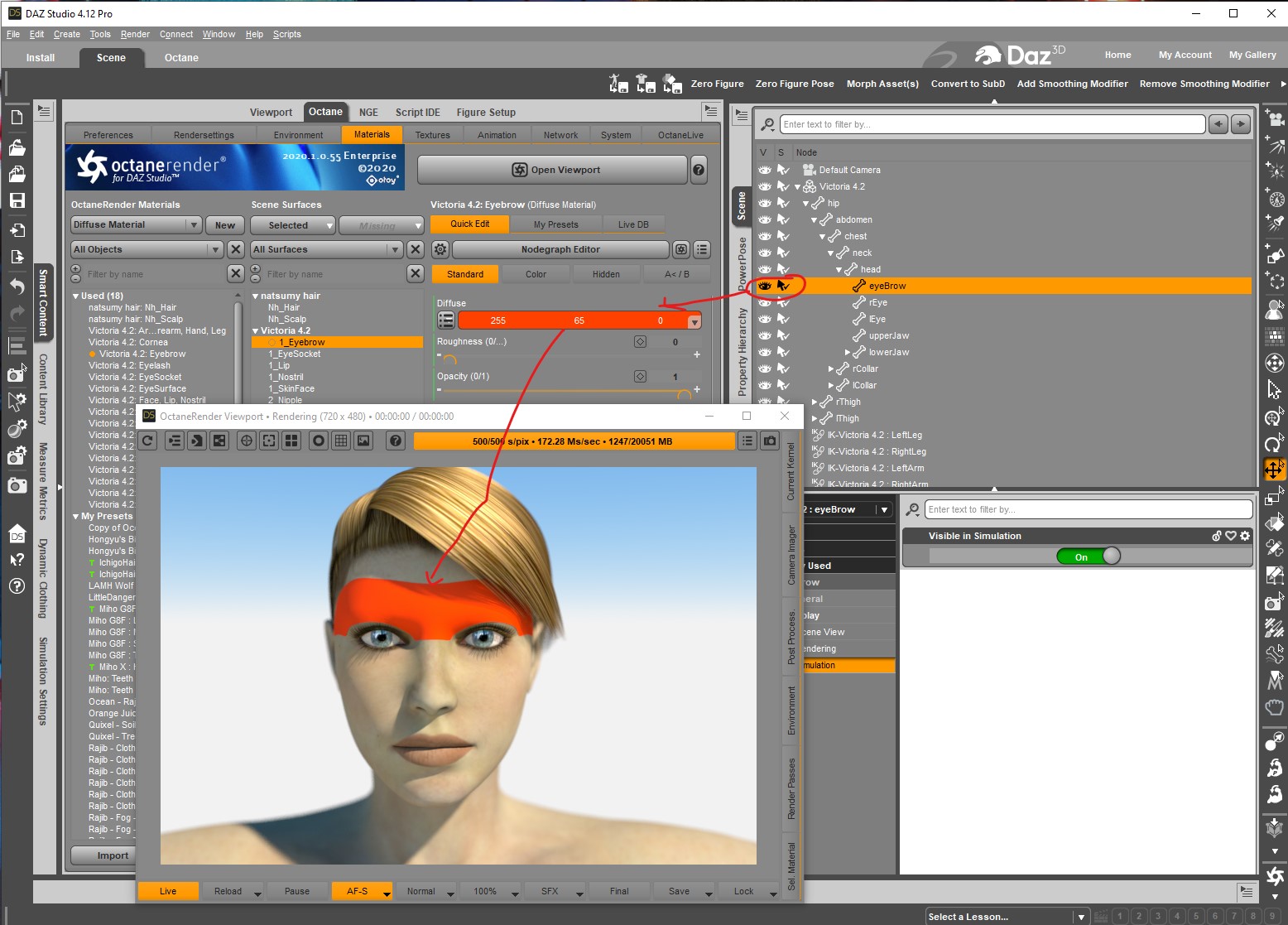

With the Surfaces Material Filter empty, lets say you enable the visibility of the 1_Eyebrow and lets say color is set to red. This is what I get :
1_Eyebrow visible, Opacity 1, Red Diffuse
Now if I set the Opacity to 0 in the material, there is no eyebrow mesh shown
1_Eyebrow visible, Opacity 0, Red Diffuse
So basically keep the Surfaces Material Filter empty:
Surface Material Filter should be empty
That way whether the 1_Eyebrow has visibility off in the scene tab / Visibility is on but Opacity is 0, it will not create the artifact in the forehead.
Hope this helps.

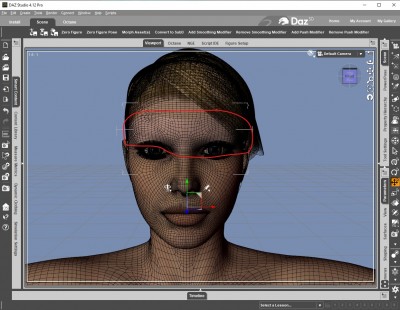

Well if you see my above post, you can see they intersect. Here is the actual wireframe view from the Daz Viewport.
