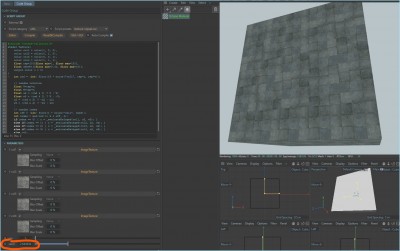

So upon investigating the length of this projection - it breaks the image down to brick-like pieces right? But it doesnt add any rotation to them right? Is there any line of code that can add rotation, or is it not that simple to implement?

Jengo_1 wrote:Got it, thanks! works great for certain materials
Thanks again, youre killin it everytime Aoktar
Yes it's for regular grid based materials. It's possible to design for rotation with some rules.

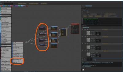

For randomizing regular tiles like brick there are OSL tilers but unfortunately randomizing rotation doesn't work here. But you can randomize them manually using different Transform nodes for each texture with rotation 0, 90, 180, 270 degree :
I tried to include random rotation by 90 degrees from different OSL's codes without success. Chaos node doesn't include stepped 90degree rotation mode.
