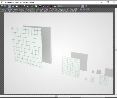

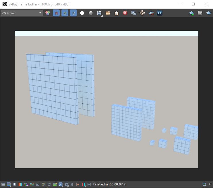

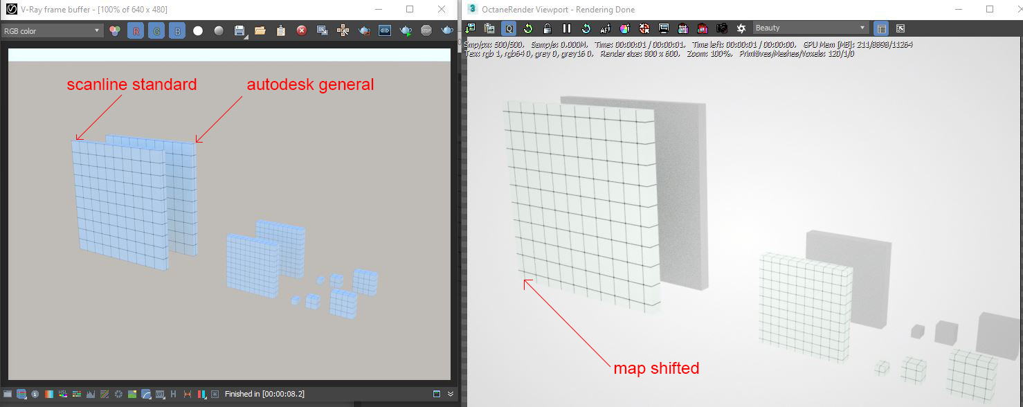

regard to the material convertion
It seems Autodesk general, physical material etc material is not yet supported,
unfortunately all geometry from revit can only be one of these two type of materials...
and also there is an issue with scanline standard mapping location, both material can be correctly reconginzed by vray
please see the below snapshot
the 3dsmax file is as attached :
Material_test0.zip
(43.68 KiB) Downloaded 208 times

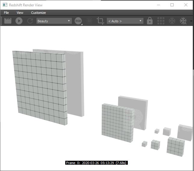

Dear Paride
thanks for your respond, but what you had answered is not what I am asking.
AGAIN:
I am asking Can Octane support (to some extent at least) material types like autodesk General or physical material which are the autodesk native material which are the only types available in revit.
at least the right scale and the location.
for architects how to line up is a important thing.
in vray the both material in the scene can be rendered correctly--right size right location
in redshift, the standard material can be rendered correctly--right size right location
in Octane, the standard material can be rendered in right size but not right location
Thanks,
Jim
Supermicro 4028GR TR2|Intel xeon E5 2697 V3| windows 10| revit 2019 |Titan V+ Quadro GV100+RTX 2080 Ti

Hi Jimho,
Those materials are not supported yet, but as I'm in the process of adding more material support, I'll add those to my list..
Thanks for your sample scene ! it will be a good starting point

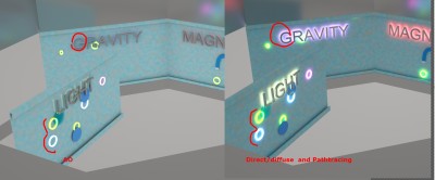

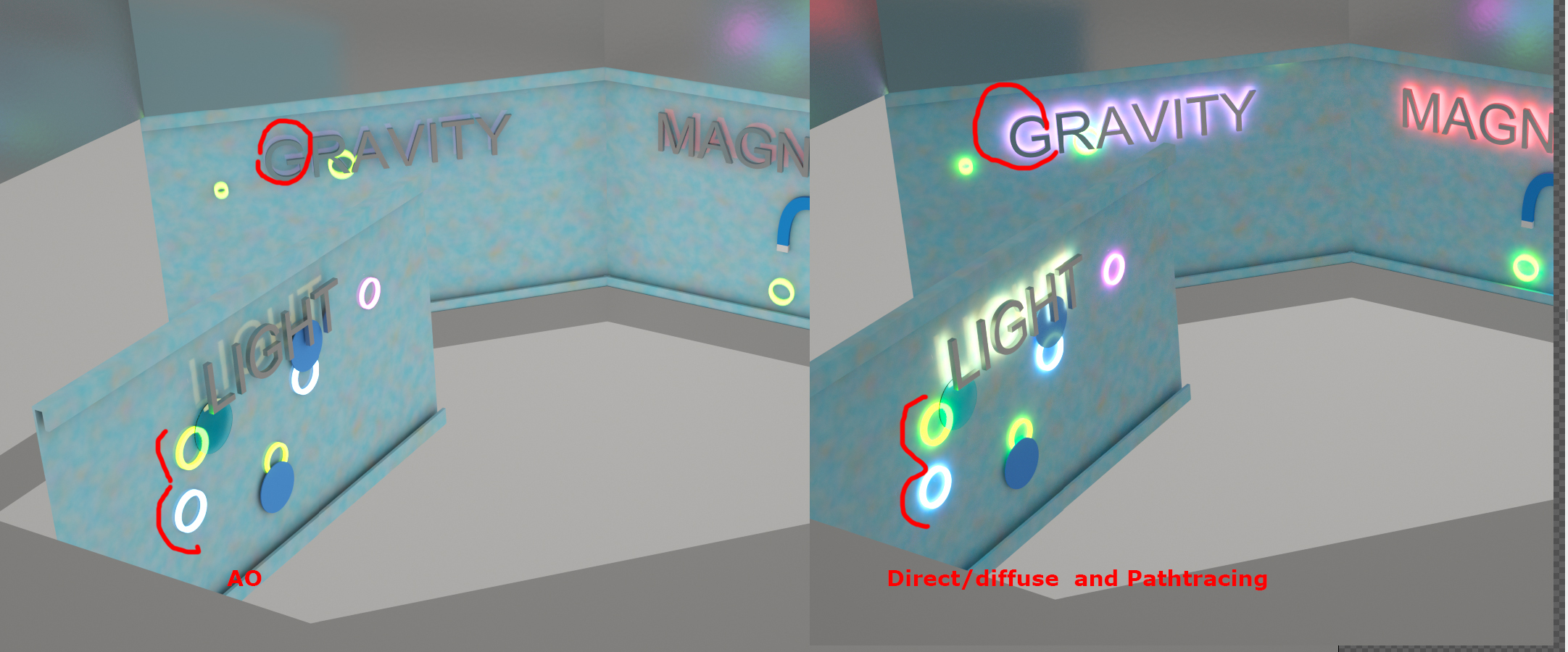

Hi Paride,
I know I asked this question before but I'll mention again.
Why cannot AO have normal direct light like diffuse and pathtracing has? In the image you can clearly see AO doesn't have good direct light at all. Can this bug be fixed? Pathtracing and Diffuse have color bleed that AO doesn't have but direct light should be the same throughout all engines.
Thank you
