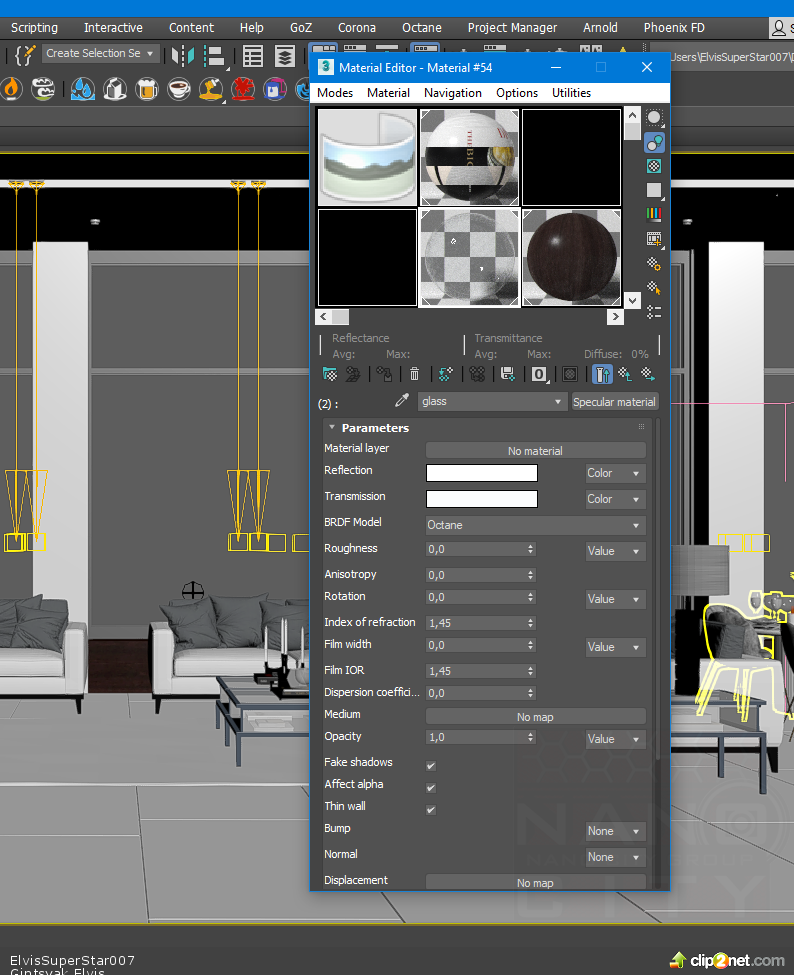

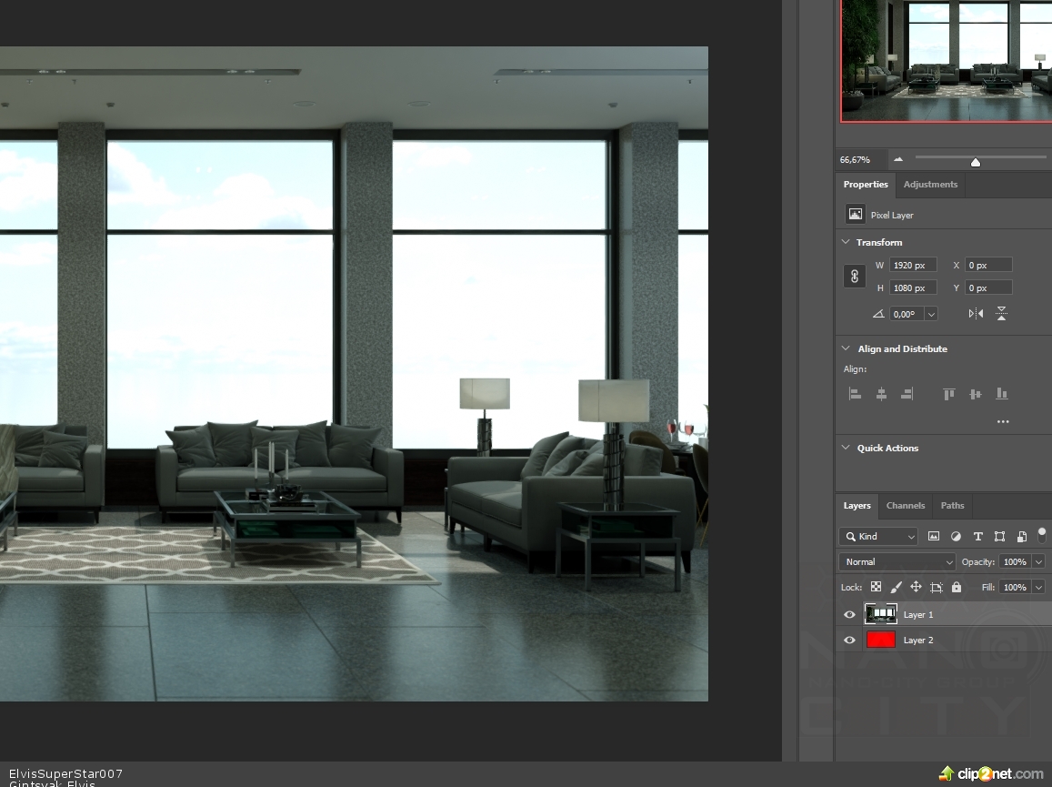

alpha channel does not work on glasses

Elvissuperstar007 wrote:alpha channel does not work on glasses
Hi Elvissuperstar007,
you would check alpha channel in Kernel panel too.
Saving your render don't forget to use alpha channel embedded file (.png, .tiff, .exr...)
Regards

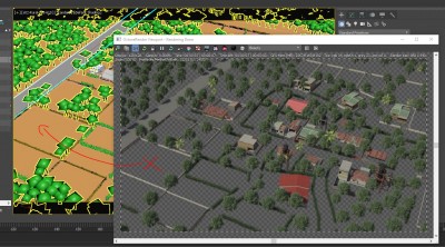

The PLANE object is not rendered if I want to render out a sequence in max!!!!
when u open the octane render window the plane is not shown, u have to press rebuild scene for it to appear... but whatever i do..when i render out a SEQUENCE the plane does not show... REALLY GUYS??? A PLANE??

nildoe wrote:The PLANE object is not rendered if I want to render out a sequence in max!!!!
Max2018 and octane 8.19
Hi nildoe,
I tried unsuccessfully to replicate your issue.
Could you share a sample file and some screenshot about this.

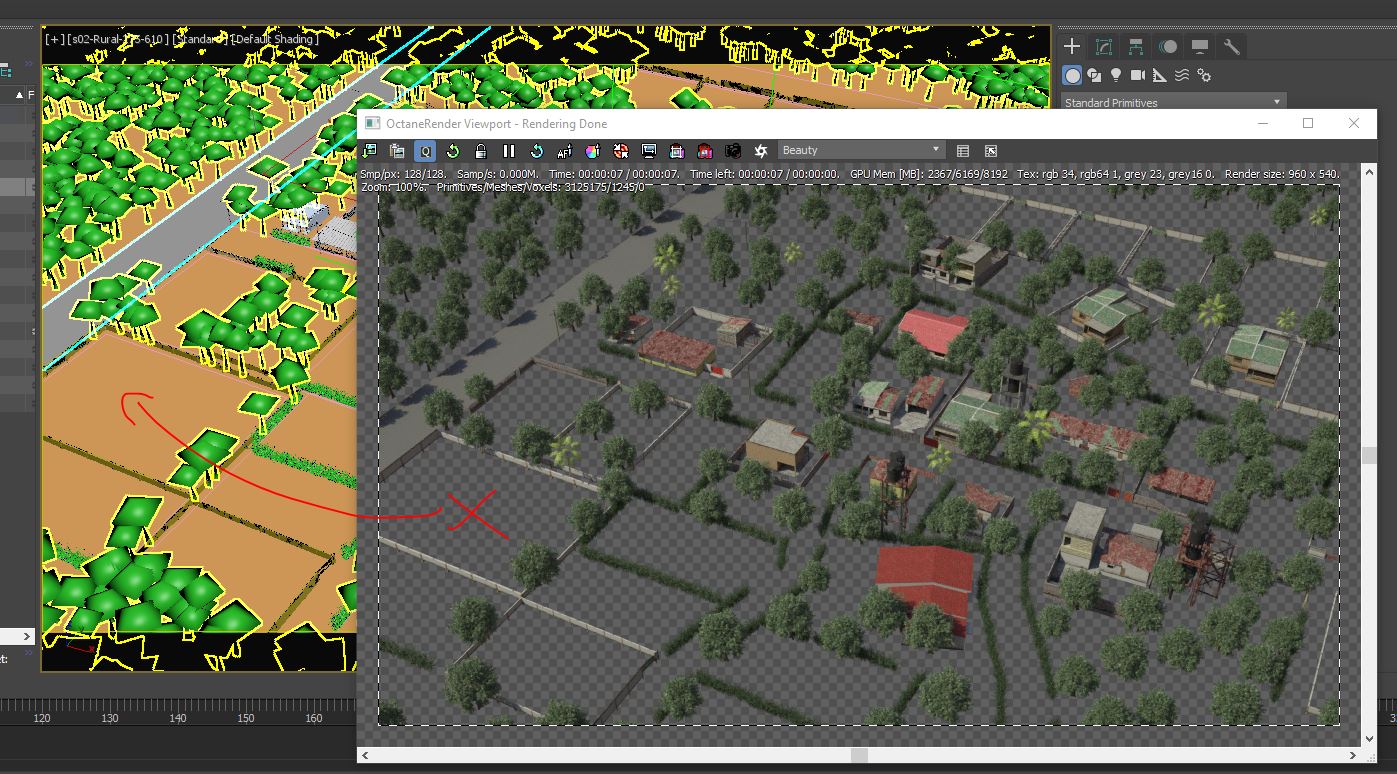

Upon first opening the scene i get this..if I re-open it (without saving) and render..it renders :(
I can't share the scene file...its too big and my internet is very slow... whats weird is that when the plane btw its not just a plane..if I make a new simple box (in this scene its a box since the plane was not working)..at first it seemed to work..but even with the box sometimes it renders sometimes not..
Edit: I really DON'T understand what's happening..if i ISOLATE the plane and render..it renders...it seems to be a random bug.. if I unhide allprevious hidden objects by isolate and render the sequence all renders fine.... I even tried merging the scene to a new max file..it happens all the same.
Edit2: I'm getting this issue even with 8.18 :(, and it seems that if I select the plane and all the other objects in the scene and render its renders fine..but i have yet to confirm this...

Hi nildoe,
thanks, could you
Could you share a video while running into the issue?
