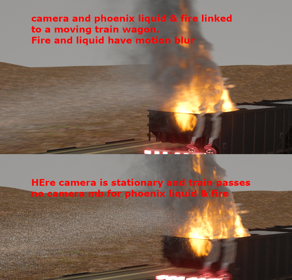

Hi Paride,
I asked them many times about this problem where phoenix grid creates an opposite effect with camera motion blur when ti is linked to a moving object.
When will they fix it?
Original post viewtopic.php?f=81&t=70717

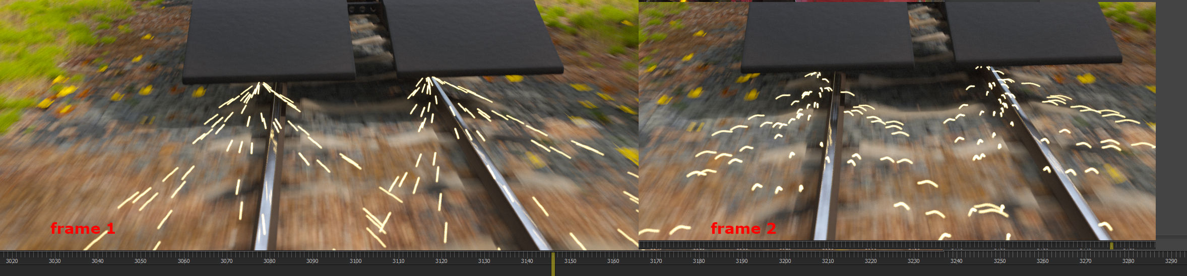

Hi coilbook,coilbook wrote:why can't you fix standard particles motion blur direction once and far all. We posted like 5 reports for many years about incorrect mb direction at different frames
I re checked some of my samples; it works for me;
it could come from loading an old scene, that would need to update some settings.. or maybe issues with MB sample count more than 2 ..

Thank you. I will share the scene tomorrow. Please look into instance objects like itoo using too much vram. We went from 400k grass objects to 1.4 mill and max crashes even though it's just instanceneonZorglub wrote:Hi coilbook,coilbook wrote:why can't you fix standard particles motion blur direction once and far all. We posted like 5 reports for many years about incorrect mb direction at different frames
I'll investigate more..
