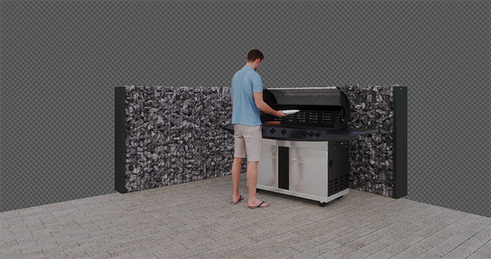

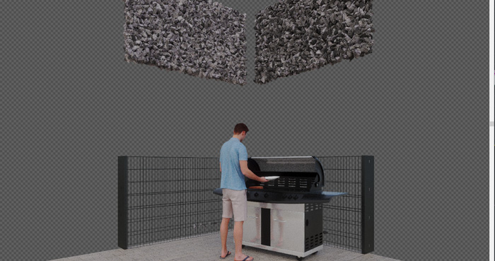

It seems my poblem is Forest Pack related. As soon as I hide all forests the scene is fast.
When I have one Forest visible the samples render like 0...1...2...0...1...2...0...and so on. It refreshes the scene over and over again. So in conclusion, the more Forests I unhide it gets less and less responsive.

More crap with Forest Pack.
With Direct mode the forest floats and doesn't stick to his scatter mesh.
With old Legacy mode all was fine.
Fix it! I need to work, earn money and don't want to test the pseudo stable stuff with every release creating more bugs.
