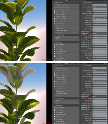

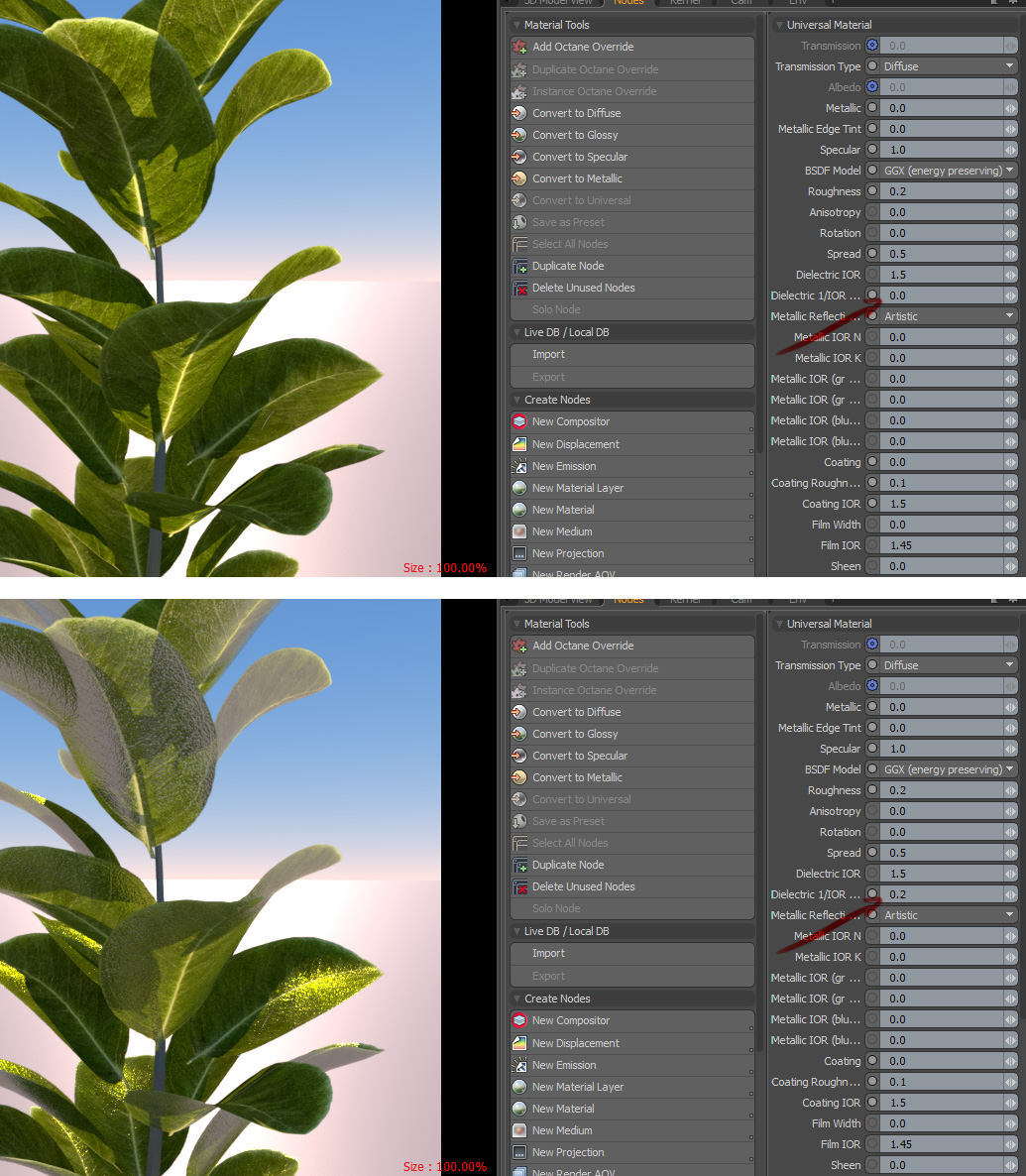

SSmolak wrote:What about this ? Should works fine now. You didn't have any Dielectric/IOR map. Also you can add a little metallic effect.
IOR is 1.5 which i think is OK for leaves and i don't think 1/IOR is needed unless metallic?
in any case depending on the view angle that doesn't work. way too much reflection and specular colour is very metallic (which i think is what 1/IOR is supposed to do?)
i'm still transitioning to Octane though and haven't used the Universal material til now so could well be wrong.
