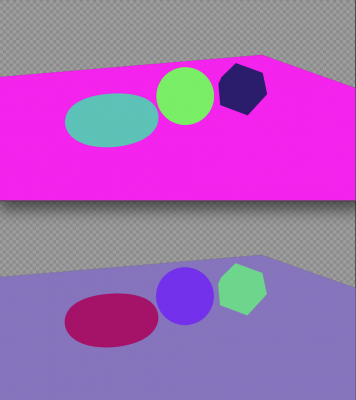

Yup, I can confirm this. Simply re-sending the exact same scene to Octane generates completely new Cryptomatte colors. It's quite a pain having to re-assign the mattes every time a new render is updated in AE, so for the most part, we don't bother with Cryptomatte.
Here's a sample for what it's worth, Ahmet.
CryptomatteSample.c4d.zip
Basic Cryptomatte project file
(123.59 KiB) Downloaded 228 times
Random Mattes, no change between renders

Did you guys try Ahmet's suggestion of using CryptoMaterialNodeName? My results confirm both what you all are seeing and what he is suggesting.
I tested this by rendering one frame of Frank's project and then the next as a separate render.
CryptoMaterialNode - different colors and selection numbers in AE
CryptoMaterialNodeName - identical colors and selection numbers in AE
Posts: 16068
Location: Türkiye
BCres wrote:Did you guys try Ahmet's suggestion of using CryptoMaterialNodeName? My results confirm both what you all are seeing and what he is suggesting.
Yes! Unfortunately, me and team have a lot of things to do. This is unnecessarily long discussion I believe. Without giving enough information and don't try different ways that should be avoided.
CryptoMaterialNodeName should be way to GO, avoid to use CryptoMaterialNode until we fix it if possible. It's not keeping IDs between sessions. Don't know if possible to fix.
