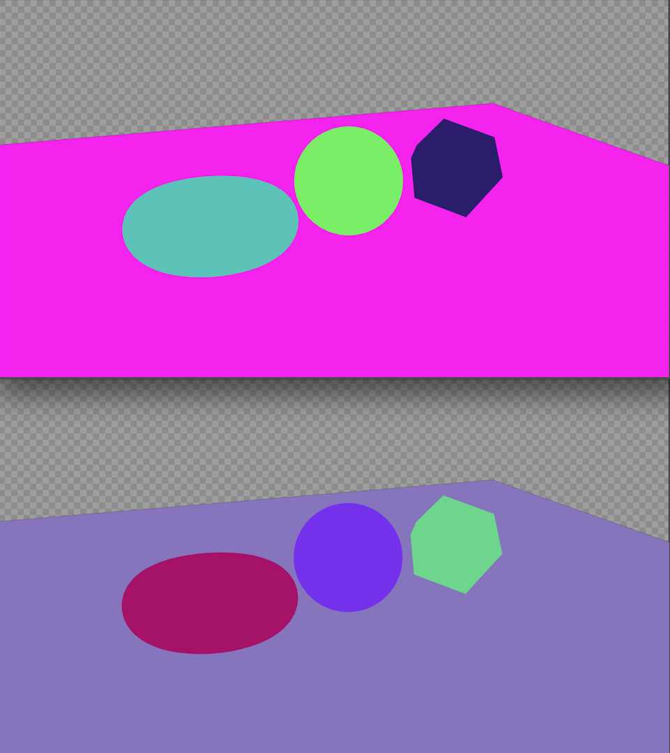

Yup, I can confirm this. Simply re-sending the exact same scene to Octane generates completely new Cryptomatte colors. It's quite a pain having to re-assign the mattes every time a new render is updated in AE, so for the most part, we don't bother with Cryptomatte.aoktar wrote: I didn't see this case on my sample scenes. Have you changed the count of objects in the scene while rendering?
Here's a sample for what it's worth, Ahmet.

Did you guys try Ahmet's suggestion of using CryptoMaterialNodeName? My results confirm both what you all are seeing and what he is suggesting.
I tested this by rendering one frame of Frank's project and then the next as a separate render.
CryptoMaterialNode - different colors and selection numbers in AE
CryptoMaterialNodeName - identical colors and selection numbers in AE

CryptoMaterialNodeName should be way to GO, avoid to use CryptoMaterialNode until we fix it if possible. It's not keeping IDs between sessions. Don't know if possible to fix.
