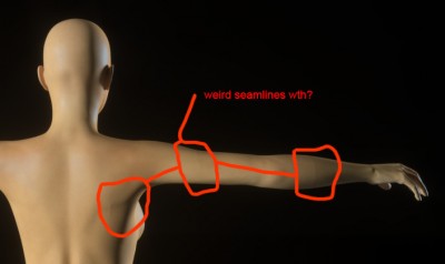

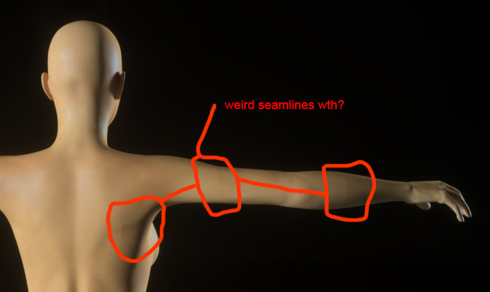

So I upgraded to 4.02.1.19... which I really should have done a long time ago!
Anyway, I've been doing some rendering, and for the most part it's working great...
BUT unfortunately the issue with inconsistent shading along body part seam lines is still there! Again, I've observed it with different skin shaders, figures, skinning methods, kernels, the whole works. So it definitely seems like there's a problem between the latest update of Poser and the Poser Octane plugin 4.x (which I assume is still being supported?)
face_off
Posts: 15813
Location: Adelaide, Australia
Hi - can you try with the latest version, which I just posted to viewtopic.php?f=45&t=69570 (4.05.0.97).
Paul
greenwinnebago
Posts: 7
Joined: Wed Mar 11, 2015 12:57 am
Yes, I think that fixed it! Thanks so much!

I'm running poser 11.2 and octane 4.0.2 and I have identical problem. Unimesh doesnt change a thing, the problem persists no matter what i do!
The issue wasnt appearing on Octane 3... Please help...
You need to update to the latest version of the Octane 4 plugin (link is just above this post).

The 2019.1.1.97 version? Because I'm using 4.0.2 and aside the 2019 version it IS the latest version

Tigersan wrote:The 2019.1.1.97 version? Because I'm using 4.0.2 and aside the 2019 version it IS the latest version
4.05.0.97 -> viewtopic.php?f=45&t=69570
