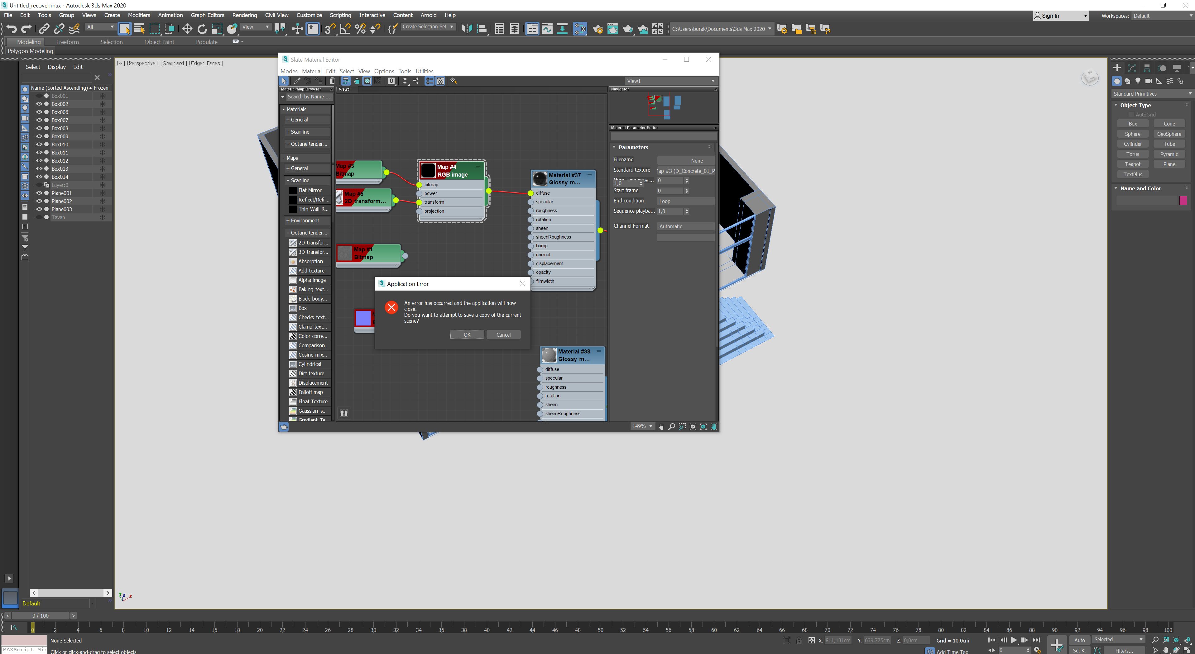

Another problem with 6.21. When I add the bitmap node, 6.21 is crashing.

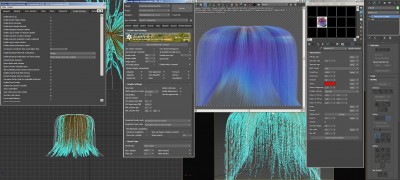

I setup a forest (itoo forest) with a dog (hair and fur).
They are main decor and main character.
What can i do to be able to deliver my animation in time ?
This is very urgent.

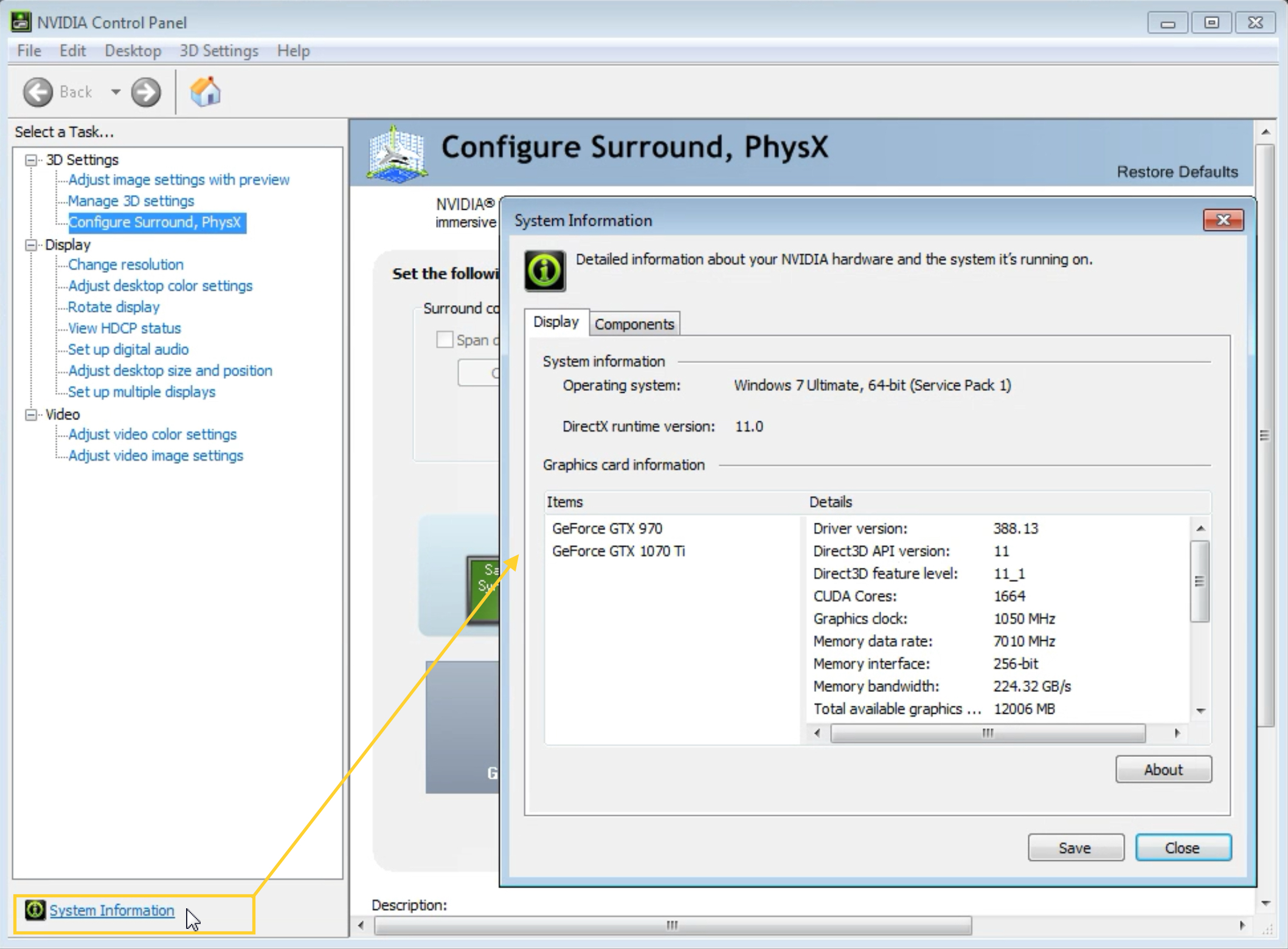

Please navigate to your Control Panel/Nvidia Control Panel, press the System Informations link, and share a screenshot like this.
Regards

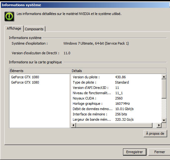

thekwen
Posts: 109
Joined: Sat Jun 01, 2013 2:26 pm
Thanks for quick response:

Hi thekwen,
try 436.48 I hope it helps; new Ornatrix and FP support is in Octane V2018/2019 OctaneRender setting > Tool > Open Octane Global Preferences > Sipport.

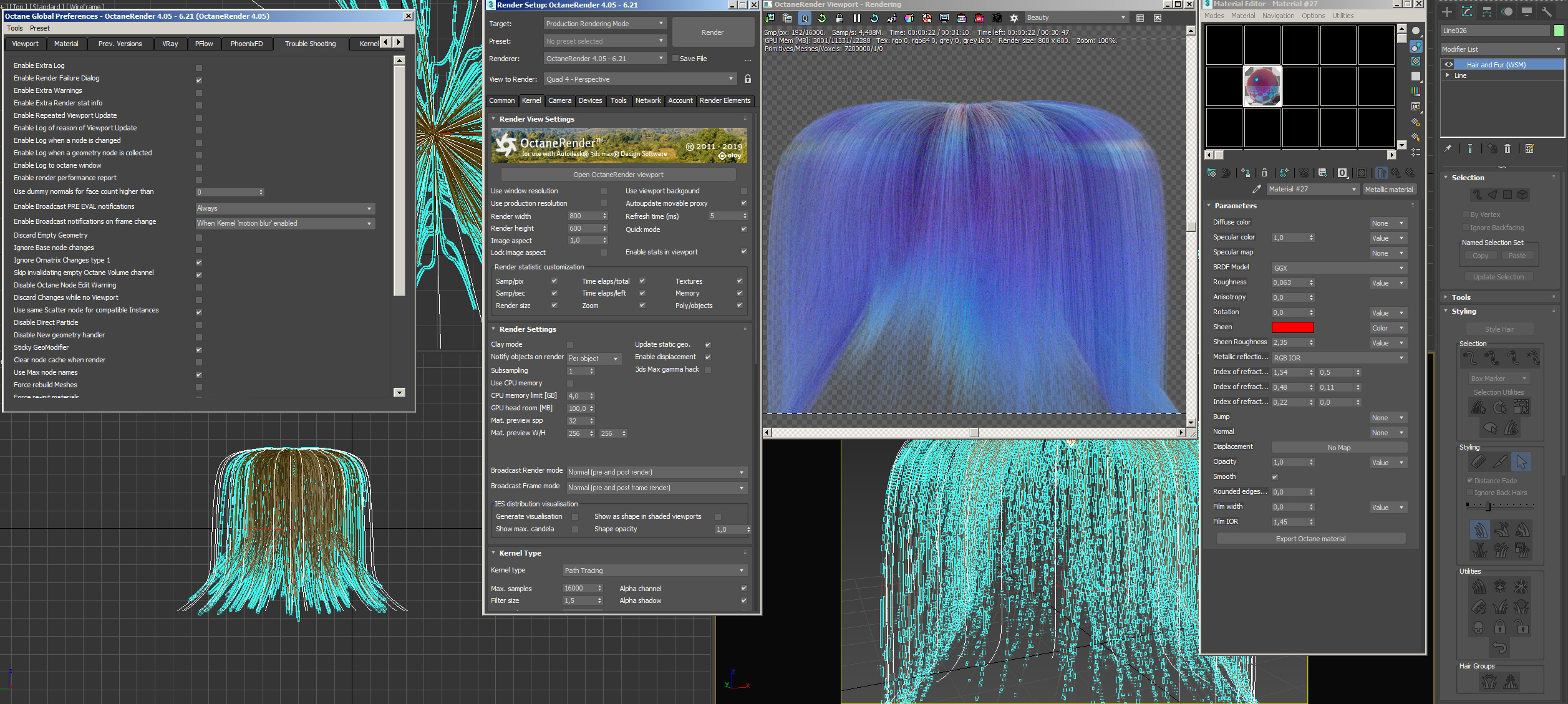

Said that, hair and fur seems to work, I dowloaded a FP sample file and rendered, it seems to works too.
Try to take a look about my setting into the screenshot,
Regards
