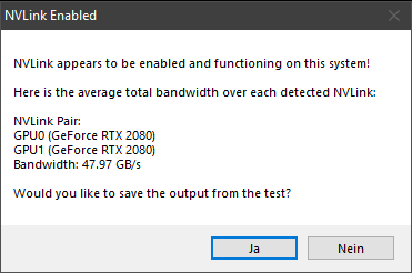

C4D + Octane + Nvlink working
2018.1.3
R17
2x 2080ti

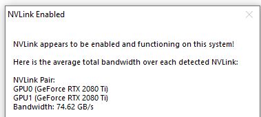

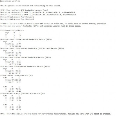

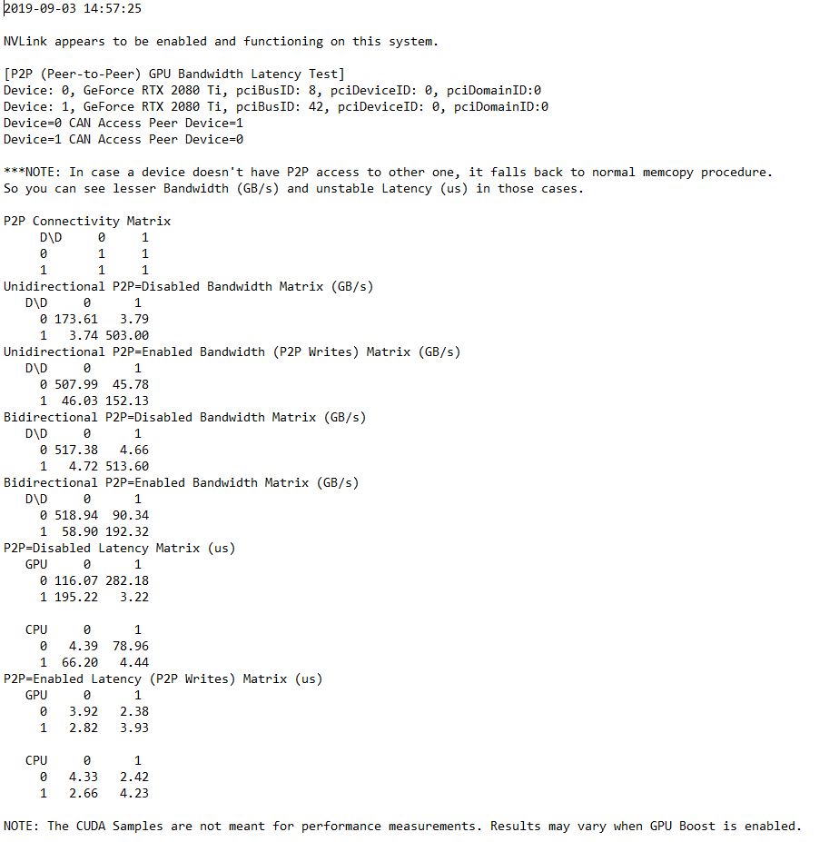

SSmolak wrote:Ok NVlink is enabled but not functioning as it should. Crashes and out of memory like using one RTX card without doubled GPU RAM.
How were you able to get it running in Octane?
I also made the NVLink Test with the tool you mentioned and its working. Still, no luck with Octane.
