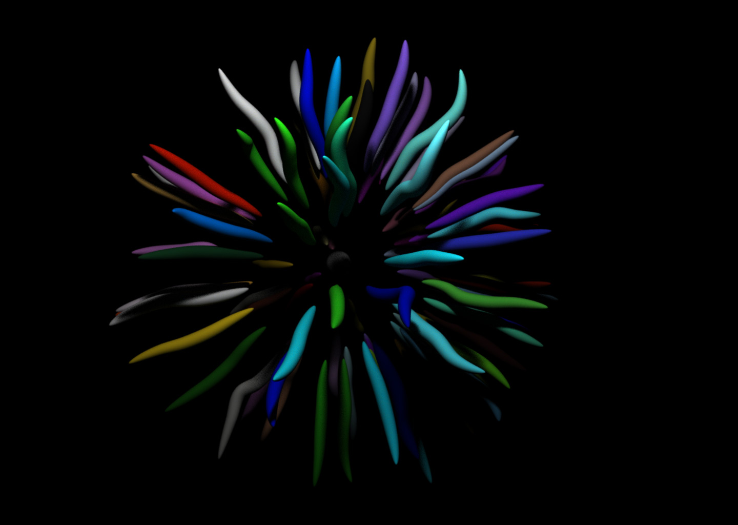

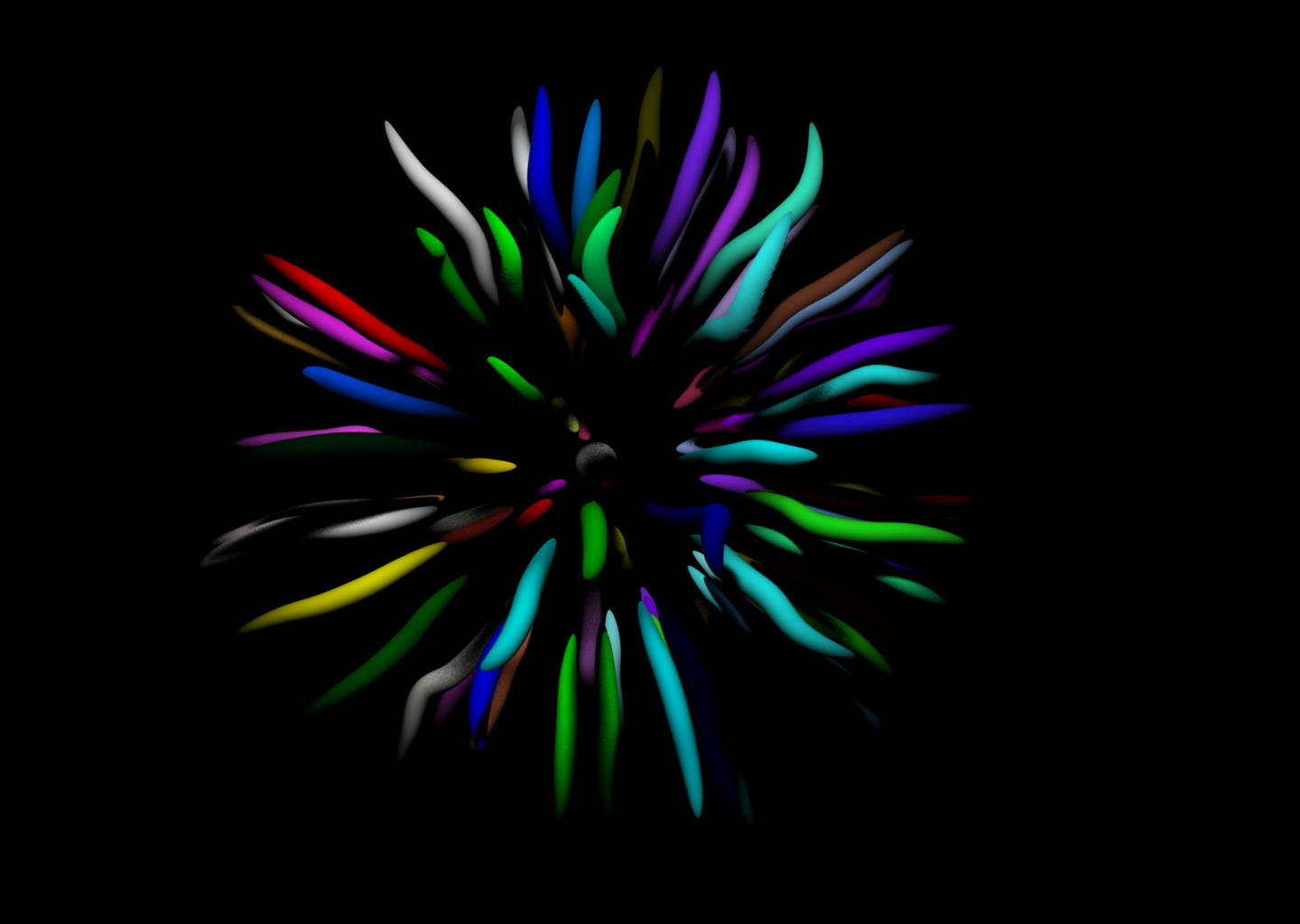

Quick strand comparison between Softimage and Octane...
They should be match ;)
I think the Softimage normals aren´t correct...
face
Softimage
Softimage
Octane
Octane
