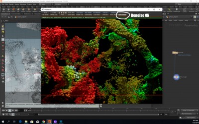

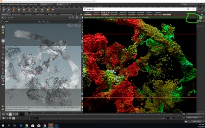

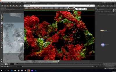

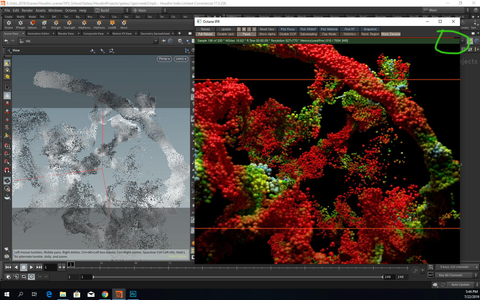

I was making a particle simulation. I was adding color using the 'pack color in the uv map', in the particles properties tab.
When the render finish in the IPR, the colors change. When Is rendering the colors are ok.
I am attaching two images to show the problem, and the scene file.
Thanks,
Saulo

Hi Juanjo,
You are right. The problem is when the denoised version is activated.

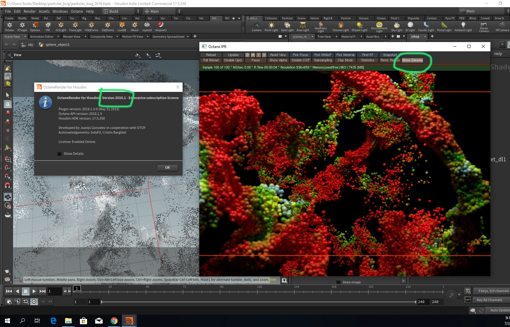

About the problem with the denoiser, it is weird that I can't see it here. What NVIDIA drivers are you using?
Thanks,
-Juanjo
sauloarruda
Posts: 59
Joined: Tue May 13, 2014 2:56 pm
I am using Nvidia Studio driver version 430.86.
It is strange also because I have other scenes with particles, and this problem doesn´t appear. I tested this from Rohan Dalvi, and It is rendering correct.
https://www.youtube.com/watch?v=h90Q9U8nZqU
sauloarruda
Posts: 59
I used the 2018.1 version, and this problem does not appear.

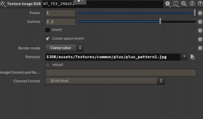

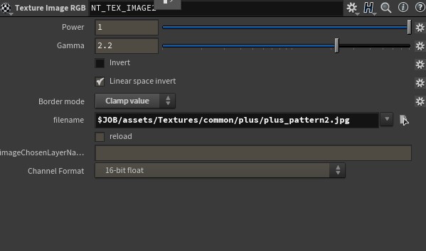

I seem to be having trouble playing around with the texture border mode. If i'm not mistaken in previous octane versions, all the modes worked?
Wrap and Mirror modes work, the rest do not. Could you confirm?
thanks
Yaniv
