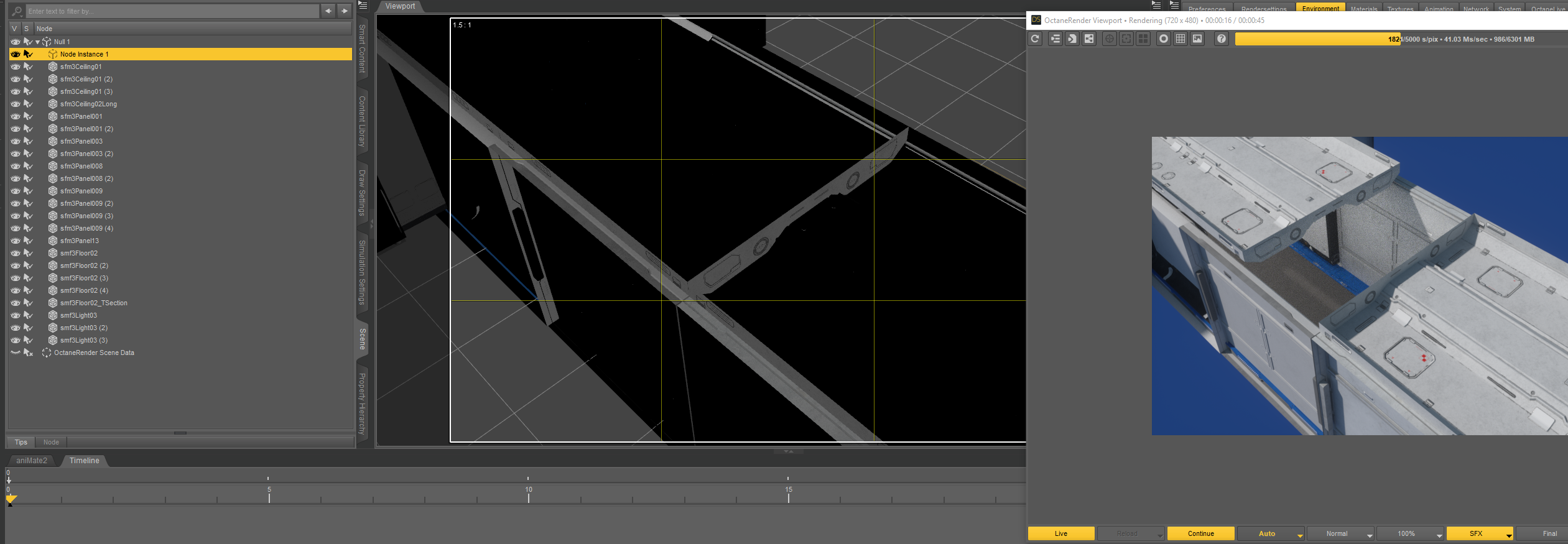

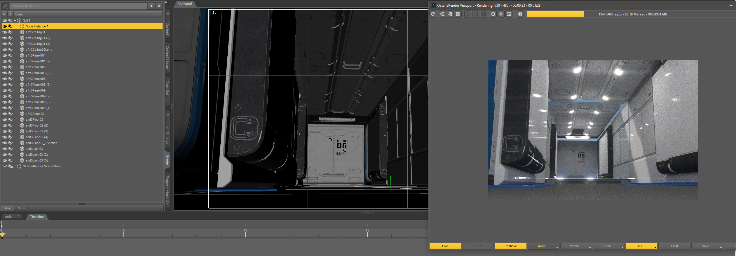

on v2018.1.0 I appear to be having a problem with a set using instances. I dont know if it was like this in v4 but I guess instances have always been an issue with this plug-in. I have attached some screenshots.

Sorel wrote:Greetings Paul.
Yes, it is a problem with v4 as well... everything is compatible except the things that aren't.
Yup, instances have always been a problem since V3 (Not sure regarding V2 because never used instances with V2). Though I must say Paul has worked with us to solve a lot of the instances issues and I would say they are mostly usable now but there are situations where they are still a problem. I am preparing a test file for him and will PM him that this coming week. Hopefully that will help to debug some of the unresolved issues. One thing you can try to do is do the rebuild scene. That sometimes helps.

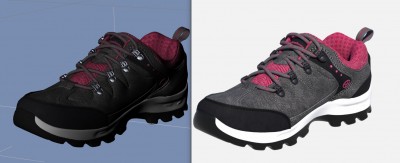

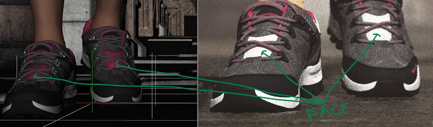

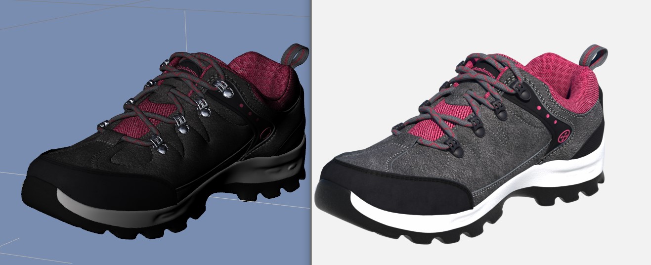

There is a bug in all the version (2018.1, V4, V3). If an wearable object (shoes / clothing) has a surface named 'Face' and the wearable object is fitted to the character, the plugin does not show the surface name 'Face' under the Materials Tab for that wearable object. You cannot set any materials for it as the surface is not recoganized. I had faced this earlier but never could figure out why the material would not set on that surface. Today I noticed that the 'Face' surface itself was not being shown in the Octane Material Tab. Clicking on the surface in Octane Viewport to edit it in NGE actually loaded the 'Face' material of the character in the NGE.
Original Daz Surfaces which includes 'Face'
In Octane, the 'Face' is missing
Sample render that show the material in the Daz Viewport and the missing material in the Octane Viewport
Now if I were to load the same wearable object (shoes in my case) in an empty scene, the 'Face' will show up under the Octane Material Tab and in the Octane Viewport everything will be okay.
'Face' surface present if there are no characters present on the scene it is fitted to.
The 'Face' material renders in Octane Viewport as long as there is no character on the scene it is fitted to.
Hope you can resolve this.
I believe that issue has been there for a long time. I have been gradually trying to fix instance issues, but there are still some problems. I suspect in most cases, the issue is if you have nested instances - which do not directly translate to the DAZStudio plugin - which only support a single Scatter node. If you can send me a small sample scene which reproduces this issue, please send it to me and I will take another look.
