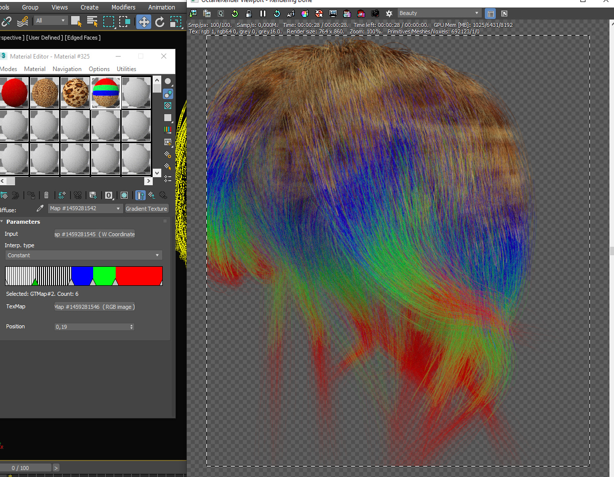

Hi Paride,
Thanks for the reply.
i feel thats a workarround. but if you wanted to tint a root of the hair and not PROJECT onto it like a solid object. as it usually done with Hair and fur plug ins all over the 3d world.
i mean that a hair maintains the pixel color at root level all throughout its length.
what, when coimbined with the gradient would get a more robust support of hair as ornatrix.
in the lastest release they stated that they are trying to get a more consisnt support for the hair plug ins.
in my case what i also see is that there is not control of the root-to-tip width . its constant
thanks and cheers
m
paride4331
Posts: 3952
Hi MartinBoom,
in my last screenshot (1st example) there was an RGB texture gadient to black, using W-coordinate.
This RGB texture gradient to R, G, and B.
Regards
Paride
stir
Posts: 101
Joined: Sun Apr 10, 2016 7:12 am
Thanks for sharing the possibilities Paride.
Looks good.
The W coordinate check box was sneaky. would never have found that on my own :P
