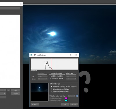

2. HDR skies are now very dark but the sun is too bright Do i need to change anything? RC7 never had this problem

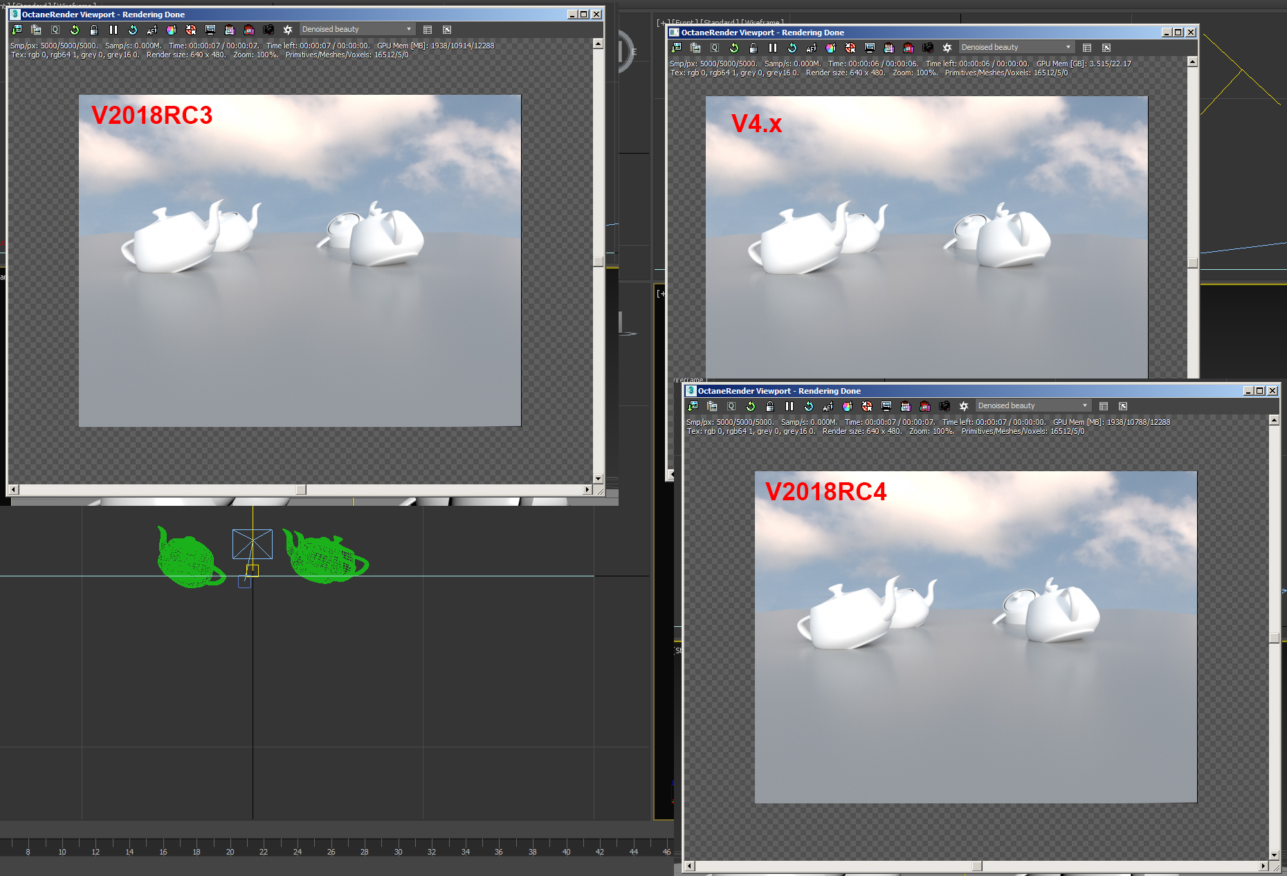

coilbook wrote:1. Octane's slow materials and making 3ds max run slow after using octane viewport for a while is still not fixed. 2 videos attached, it happens a lot when you work with textures after octane viewport was opened. Thanks
Hi coilbook,
hdri seems ok, I tested 6.14, RC3 and RC4, coulf you check if you changed something in LUT or Gamma?
I found some freezing using HDRIs in RC4, sent it to developers.

paride4331 wrote:coilbook wrote:1. Octane's slow materials and making 3ds max run slow after using octane viewport for a while is still not fixed. 2 videos attached, it happens a lot when you work with textures after octane viewport was opened. Thanks
Hi coilbook,
Yes, 3dsMax material editor goes slowly, I hoped in new Nvidia drivers, but nothing.
Regards
Paride

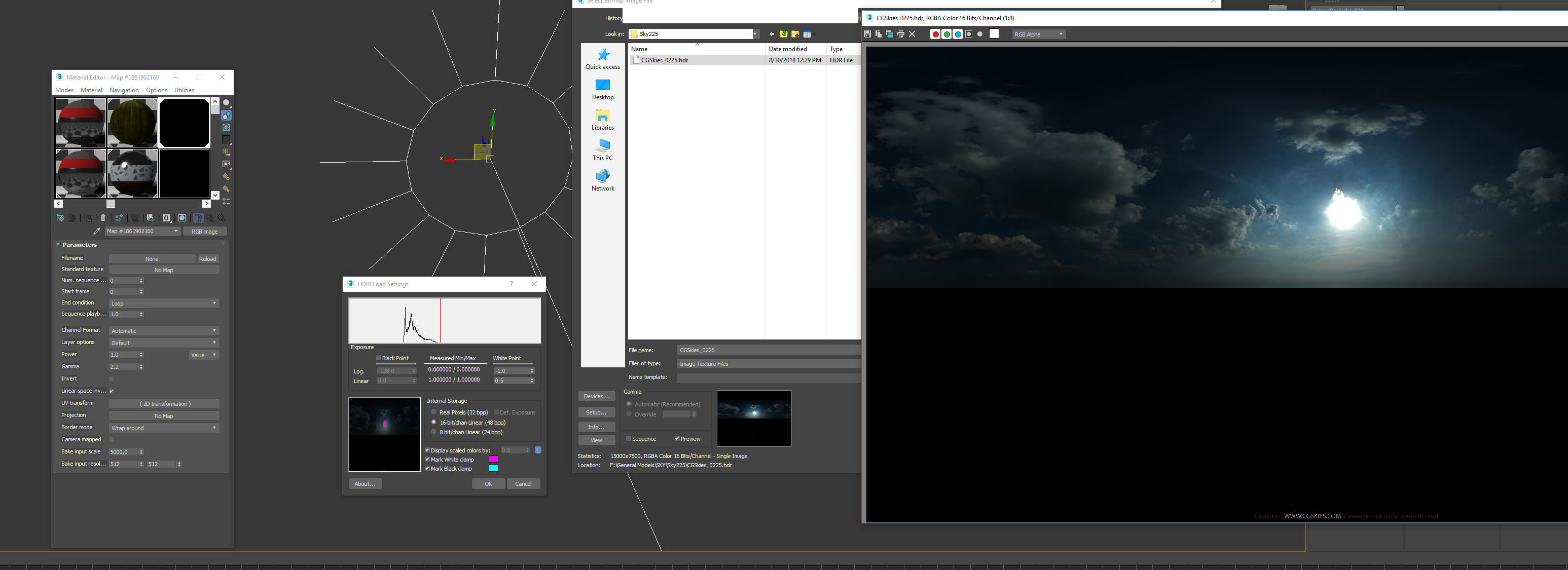

Hi paride,
I am using 4.02.1 6.14 I sent you HDR map as PM Can you try it? I am not sure what I am doing wrong. it's just dark
My scene also has enable gamma and lut disabled

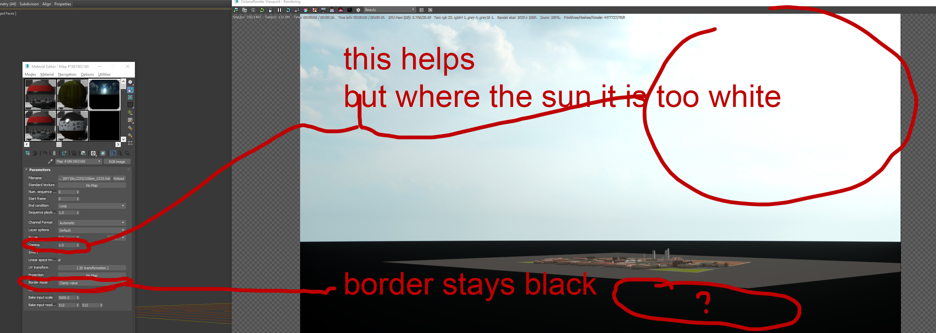

Looks like setting gamma to 1 in the material editor helped but now i have two problems:
1. Making the sky bright makes area around the sun almost white. Anyway to fix this and reduce just sun intensity and make blue sky brighter?
2 Border mode still doesn't work.
And why do I have to set Gamma to 1 to begin with?

Generally speaking, 1 is the correct gamma for all maps except diffuse textures that are based on photos. Definitely HDR image formats(exr, hdr) expect gamma 1.coilbook wrote:Looks like setting gamma to 1 in the material editor helped but now i have two problems:
Why Otoy decided to have gamma default to 2.2 is beyond me. It's not correct and demonstrates a lack of understanding of the field.
