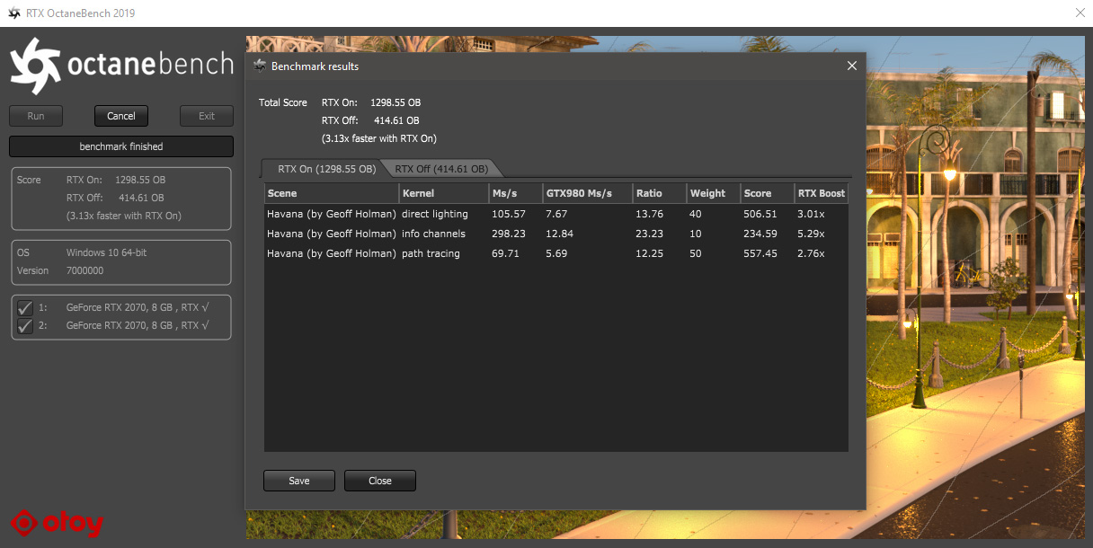

Hey, I have an RTX 2070, but when I run it I'm not getting an "RTX On" benchmark. I installed the 416.94 driver. Is the 2070 supported at this point, or is there something else I should be doing? Would love to try it out.

shapirog,
The rtx 2070 works for me in Windows 10 with driver 417.35. I get with RTX On for 2x2070 almost 1300 score. See attach picture.

In theory your GPU should be supported with the driver you use, however we didn't get the chance to test this combination in our lab so it would not be a surprise if RTX support came at a later driver for the 2070.
