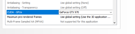

It seems better, but even though I have this setup, typing this message with a Render preview going is really slow.
I think I need to tell my Nvidia software to have Google run through the 970.
Also, the file I was having the most trouble with uses a few particle emitters. But it seems happier now.
