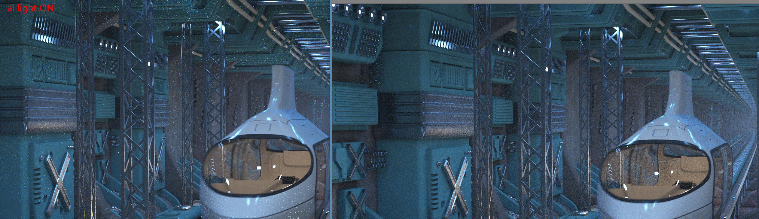

HI otoy, I sent you a couple of scenes related to ai light and noise. Also I want to add that when using ai light it generates more fireflies than when not using it.

coilbook wrote:HI otoy, I sent you a couple of scenes related to ai light and noise. Also I want to add that when using ai light it generates more fireflies than when not using it.
Thank you for that. We will have a look at them in the coming days.

I am not sure how you train your ai denoiser or it only depends on nvidia but please train it for blotchiness and noise when camera moves and light shines at specular surfaces (it looks like bright spots just move a lot even though static is checked) Thank you
