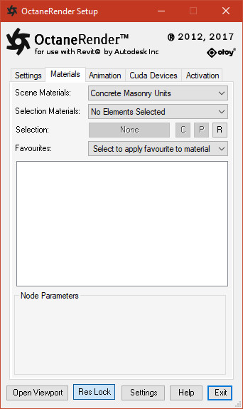

I tried the add-on version 4.02.1.58 and have an issue that the material node list is completely empty and right-click doesn't open up a context menu.
Materials are all white when rendering, therefore I assume there are no materials assigned.
From reading the change notes, I guess the PBR material conversion didn't make it in yet. Do you still think it will be implemented soon or did you experience any major issues?
Hi. It is just o some materials, or all? Is it possible you clicked on the material from a reference scene?

face_off wrote:Hi. It is just o some materials, or all? Is it possible you clicked on the material from a reference scene?
It's the demo version of the plugin btw.
All materials, I tried a sample scene, new scene and my own scenes too.
I can downgrade to the previous version and the materials show up again correctly.

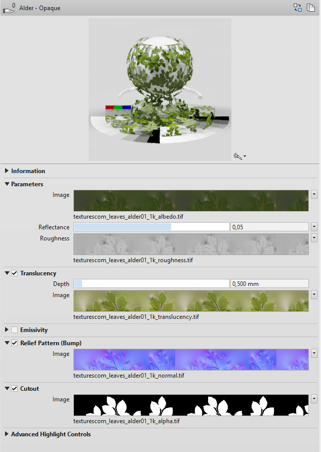

face_off wrote:I had a good look at this, and couldn't see any correlation between the Revit Physical material and the Octane Universal PBR material - they seem like completely different things. So, sorry, I don't think the Revit Physical material can be converted to Octane (unless I was looking at the wrong thing). Perhaps you could post some screenshots of Revit PBR materials and the Universal material it would convert to?
Paul
Really? Maybe I'm wrong, but I will dig into it a bit more and post some information with examples and screenshots.
So far my understanding was that they basically split the principled shader into 5 separate shaders, documented here http://help.autodesk.com/view/ARENDERIN ... C3758EE3EE
In general, even if we cannot have a 100% conversion, it would help a lot to at least convert some information.

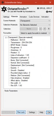

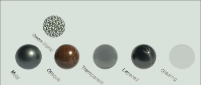

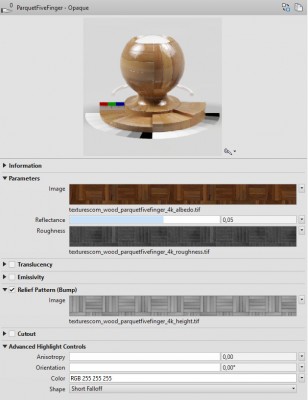

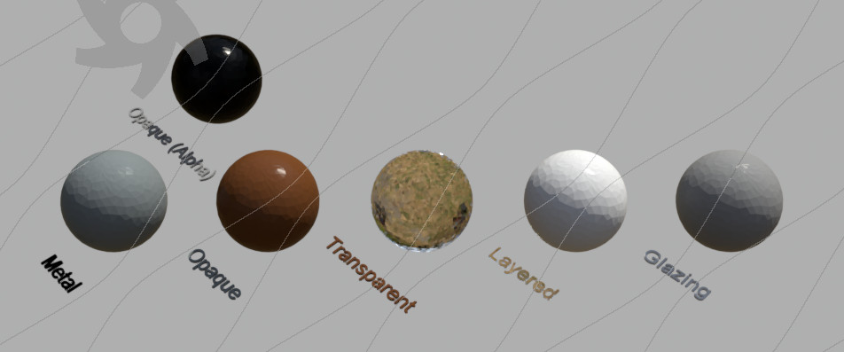

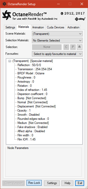

I setup a test scene with one example for each new shader, though I think opaque and metal are most important, transparent usually doesn't have a lot of texture information, therefore I start with them.
I added an opaque material with alpha transparency as well.
The material on the text of the balls is all over the place, not sure why, please ignore it.
On a side note, why are the spheres flat shaded? Are custom normals not exported?
Rendered in Revit:
Rendered in Octane:
Material setup in Revit:

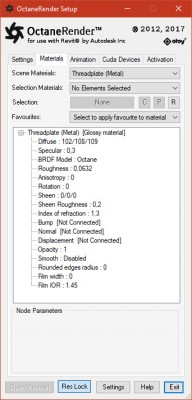

Except the transparent material all materials convert to glossy materials with the same settings except diffuse color.
I will post tomorrow how I would assume the converted universal material looks like.
Great work on this - thank you. If you could also post a .RVT which contains those physically based materials attached to the spheres that would help immensely.
Paul
