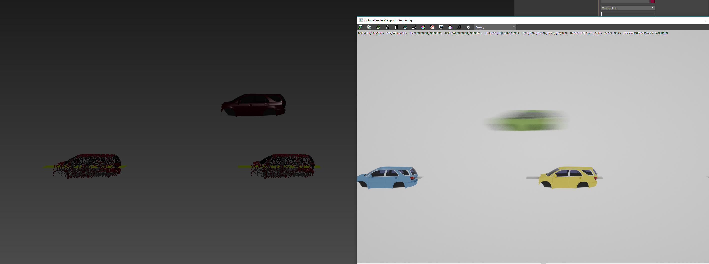

Bumped to this post so it wont get lost. With itoo and mb Here is the scene
- Attachments
- itoo mb bug.zip
- (1.62 MiB) Downloaded 213 times

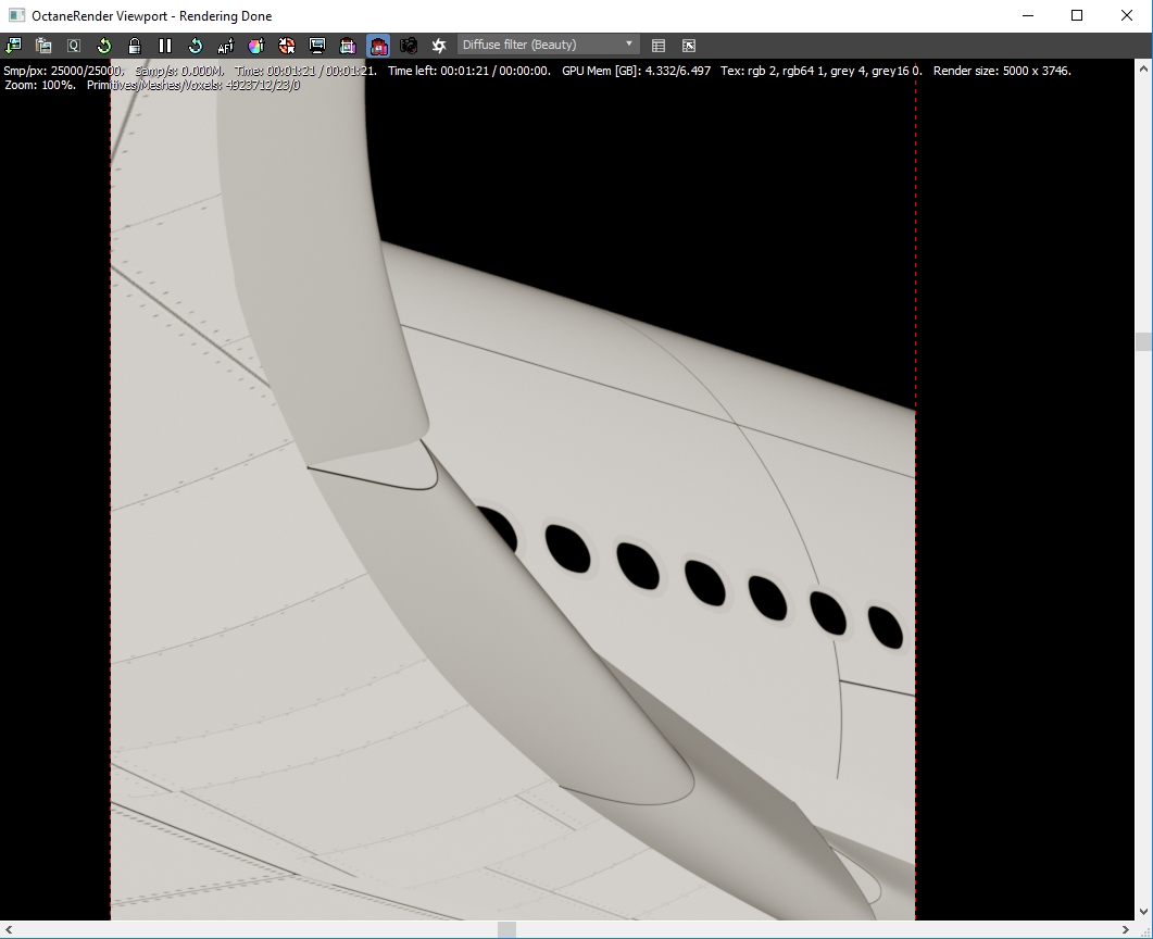

Hi neonZorglub,
Thank you for the new release
But diffuse filter pass is broken now and has shadows and shading, seems like it is using some kind of AO or similar effect
Update: this pass shows shading when you have metallic material in your scene, or mix material with diffuse/glossy and metallic

Hi coilbook,coilbook wrote:Bumped to this post so it wont get lost. With itoo and mb Here is the scene
Thank you for your scene.
I may have the motion blur working with FP for the next version.
