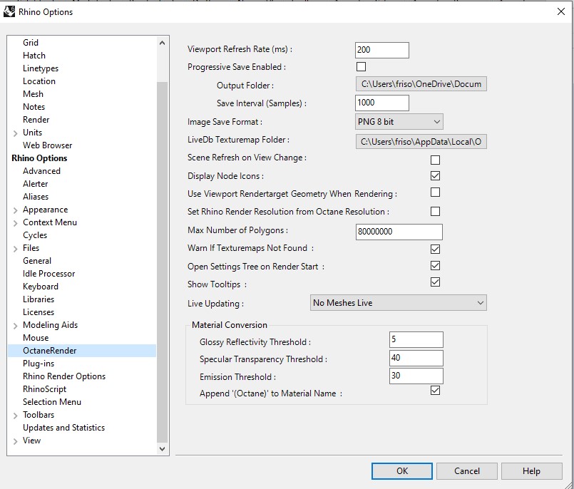

Attached a screenshot of my settings.

face_off
Posts: 15815
Location: Adelaide, Australia
These are the same as my settings.
Can you pls provide screenshots showing the problem happening on the file you provided above? Provide a screenshot for each step in the way.
