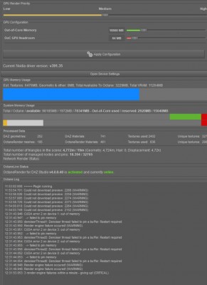

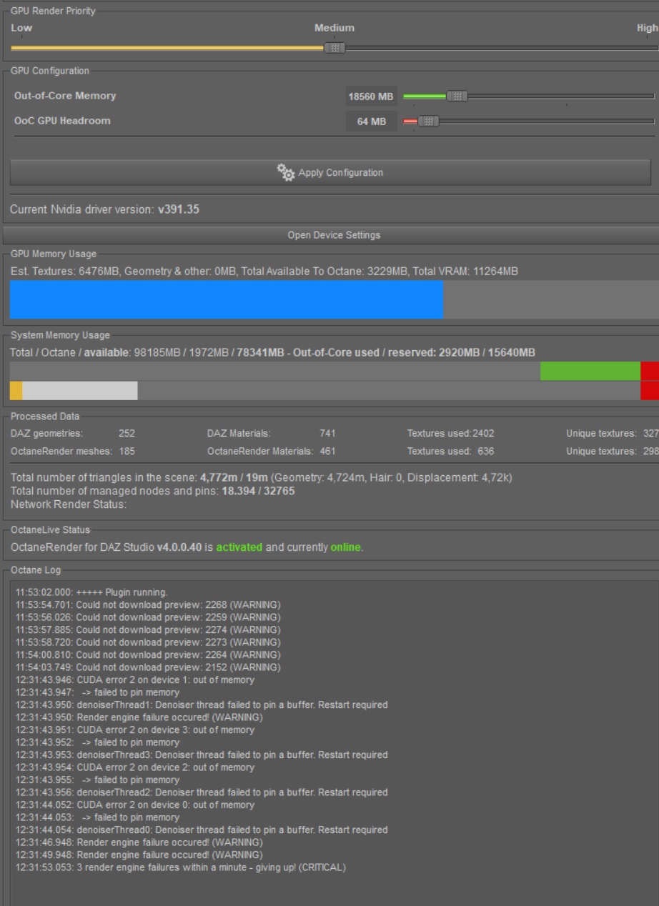

Ok ... what is this about? The scene i was testing is below 6GB big ...
Denoiser and AI light was on.
face_off
Posts: 15812
Location: Adelaide, Australia
The error log is indicating that you ran out of VRAM.
Paul

Yes Paul it does ... but in that image you can also see that octane reports 3229Mb still avaiable. Without the denoiser turned on it runs normal.
In a second scene (image attatched) the denoiser doesnt kick in at all.
I can turn it off and on ... it doesnt start working.
