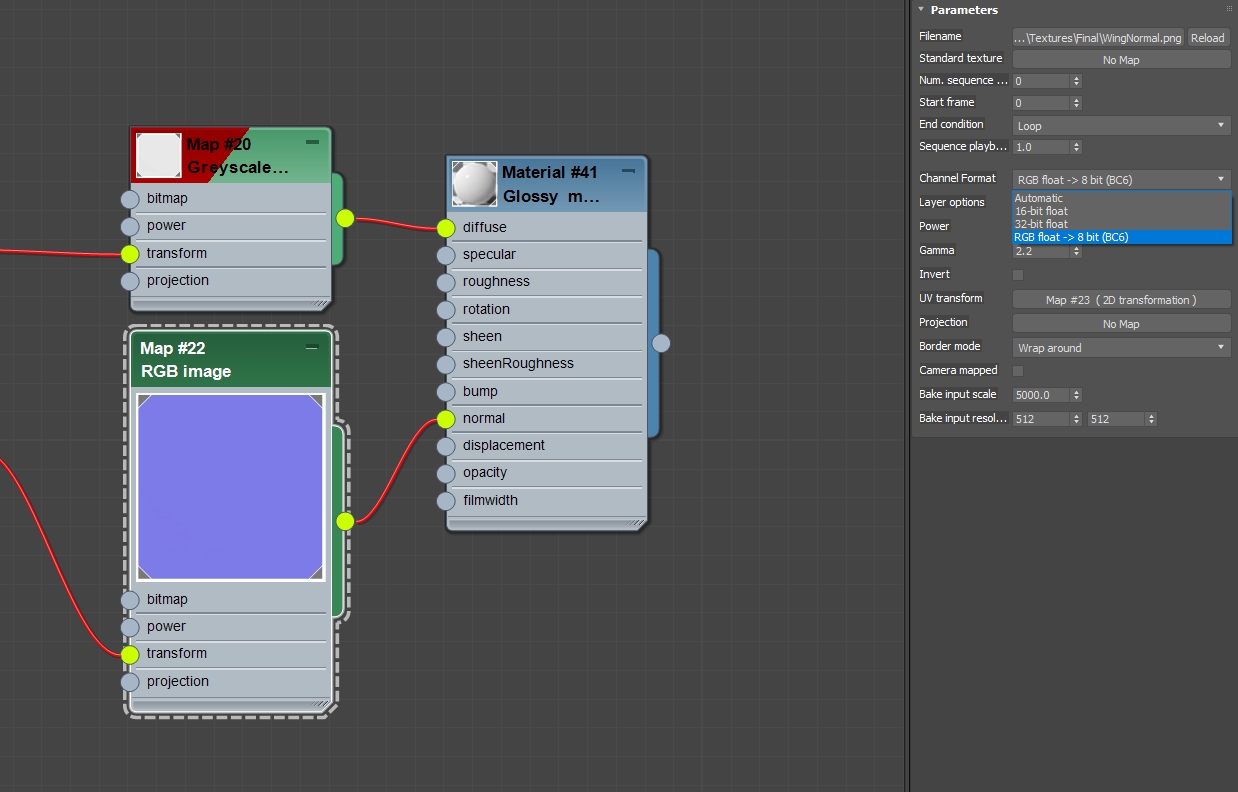

Thanks SergKlyosov,SergKlyosov wrote:I found reason why render had stuck at "Scene evaluation" stage
It is happening after texture compression of an RGB Image node
I can confirm your issue.
A workaround get back to Faster (compression).
Regards
Paride

Hi Paride,paride4331 wrote:Thanks SergKlyosov,SergKlyosov wrote:I found reason why render had stuck at "Scene evaluation" stage
Regards
Paride
For which setting are you referring to? I can't see "faster" option in compression settings of RGB Image node
Also haven't found them in the Global Settings

- SergKlyosov
- Posts: 126
- Joined: Wed Mar 01, 2017 9:33 am
I have 16k normal map which eats a lot of memory, so I decided to compress it. I don't see any quality change in my render, but it frees 1GB of VRAMDartFrog wrote:I found "faster", but I'm not sure it's working. I can't go through all my maps and change this. I'm reverting back to prev version.
I have only these options inside texture compressions settings, see attached image
Win 10 64 | RTX 3090 | i9 9980XE | 64GB RAM
