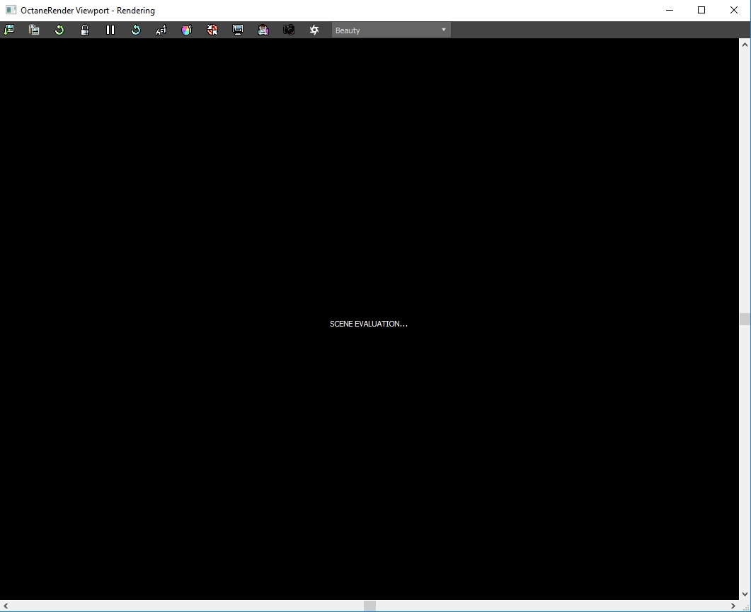

I found reason why render had stuck at "Scene evaluation" stage
It is happening after texture compression of an RGB Image node

SergKlyosov wrote:I found reason why render had stuck at "Scene evaluation" stage
Thanks SergKlyosov,
I can confirm your issue.
A workaround get back to Faster (compression).
Regards

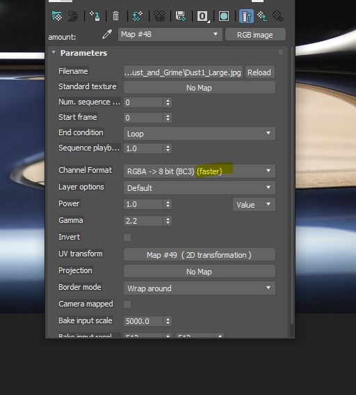

For which setting are you referring to? I can't see "faster" option in compression settings of RGB Image node
Also haven't found them in the Global Settings

I found "faster", but I'm not sure it's working. I can't go through all my maps and change this. I'm reverting back to prev version.

DartFrog wrote:I found "faster", but I'm not sure it's working. I can't go through all my maps and change this. I'm reverting back to prev version.
I have 16k normal map which eats a lot of memory, so I decided to compress it. I don't see any quality change in my render, but it frees 1GB of VRAM
I have only these options inside texture compressions settings, see attached image

I'm sure the texture compression thing 'works', but I still couldn't render. It stayed a black screen. I have too many maps I'd have to edit to 'faster' so I'm not going to bother.
