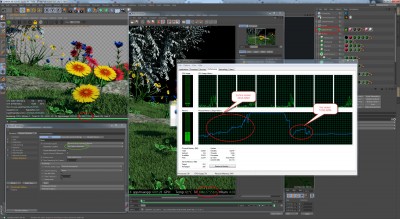

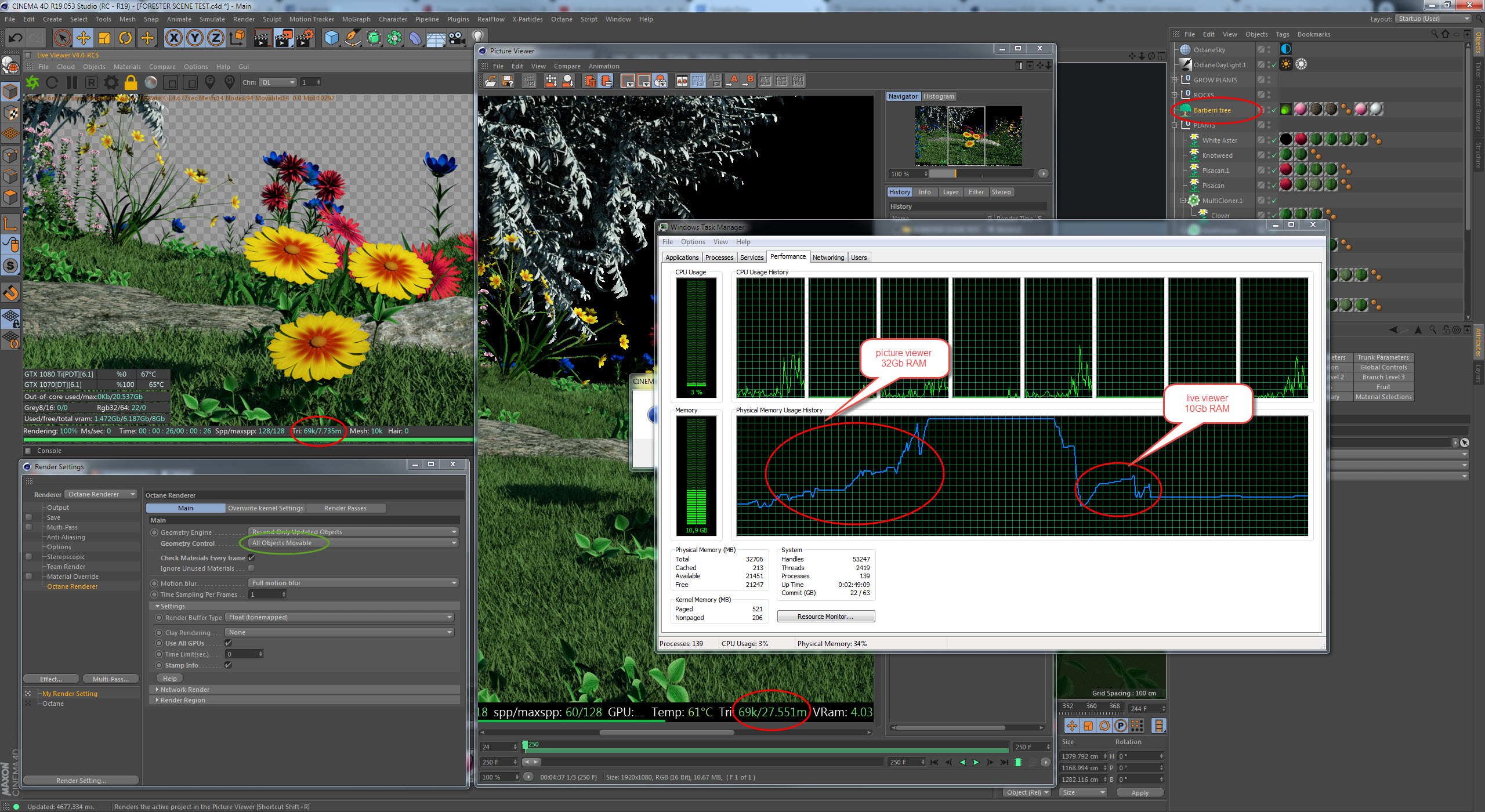

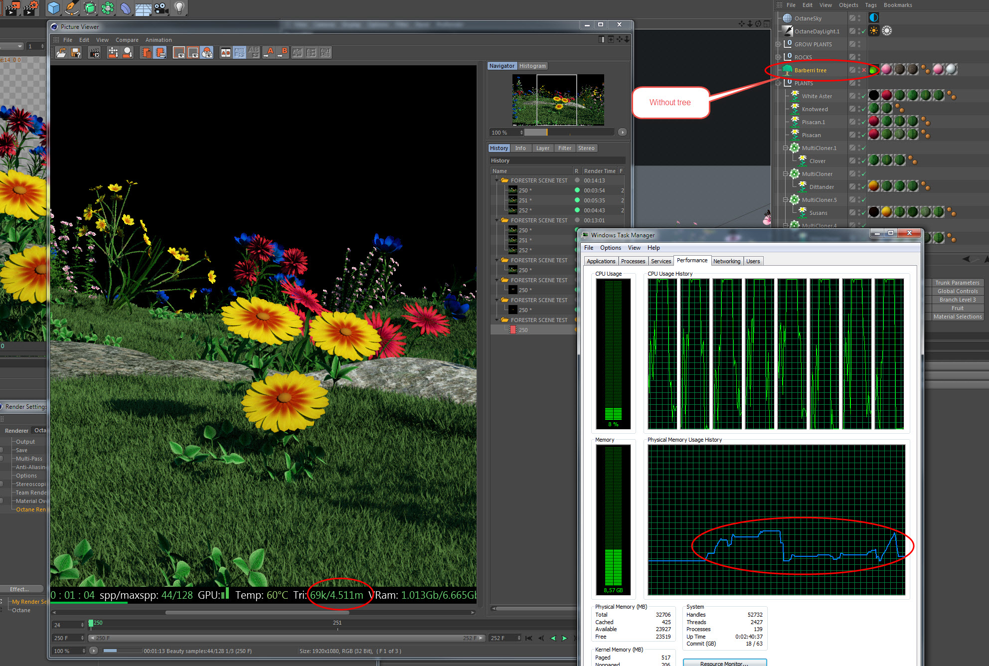

All movable doesn't make any change on your scene because there's ONE TREE with enormous amount of polygons. And It's much for Octane for one object.BCres wrote: Why does version 121 render the scene AS IS and all of the other Forester versions run out of memory? No simplifying. No changes to anything else in the scene or the render settings.
Btw I cannot know the 121 but Forester guys are checking it and answered! For my side please see pictures from my tests. Absolutely you need an optimisation on your scene if your reference is Live Viewer.
