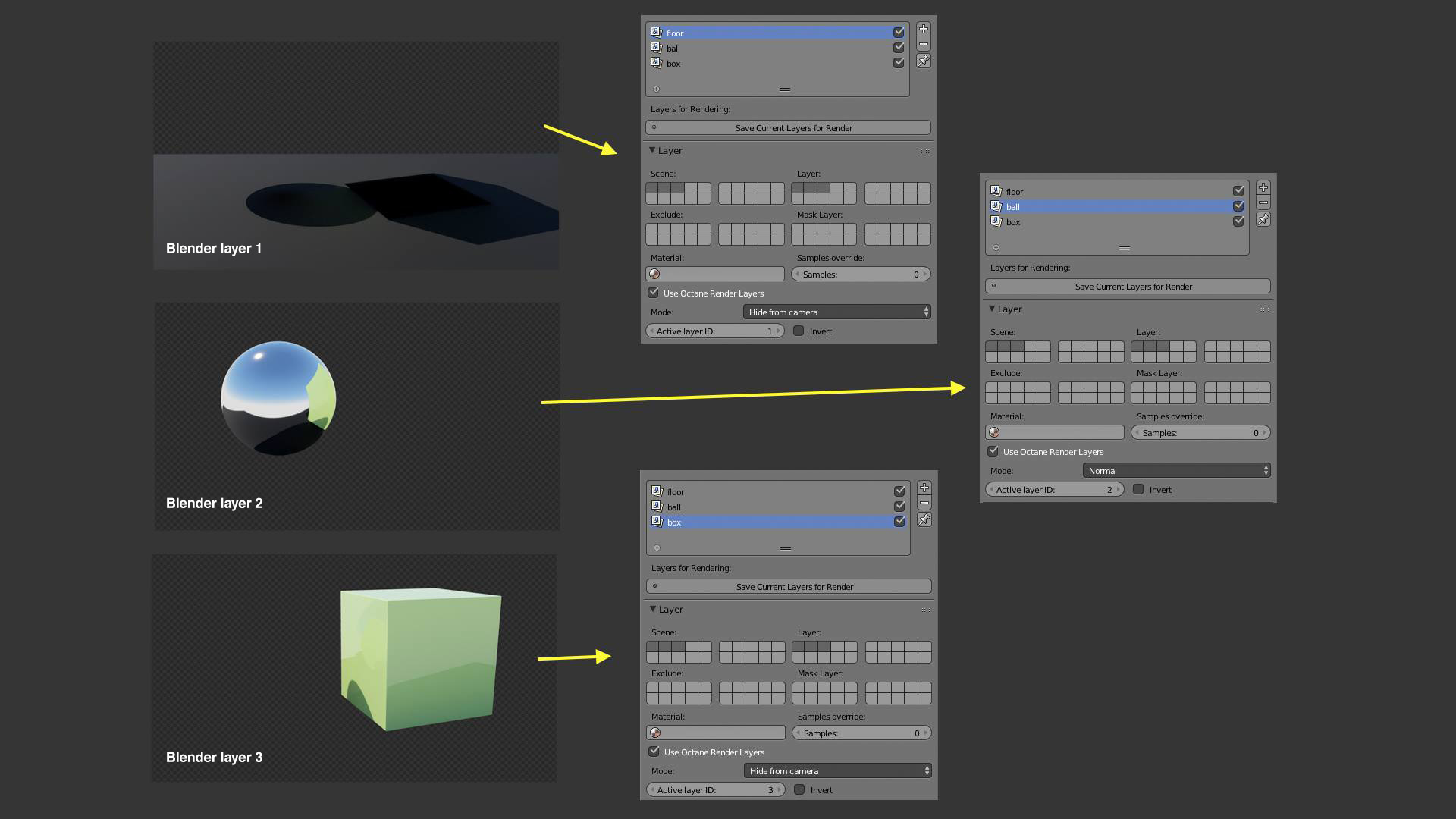

Take look at the layers setup here: Before you can use it like in the picture above you need to enable "Use Blender Built-in Render Layer" option in add-on preferences window.

This has got me somewhere - thanks a lot.J.C wrote:Before you can use it like in the picture above you need to enable "Use Blender Built-in Render Layer" option in add-on preferences window.
It's still really confusing. How do I now get shadow passes in the same set up? What is the 'Octane render layers(Global)' tab for? Why when I select 'Hide from camera' on a layer, it hides the other layer? etc. etc.
Did you check the manual?
https://docs.otoy.com/BlenderH/BlenderP ... Layers.htm
I've shown you the second method. It's good to know both because sometimes the old method is more flexible for simple renders. The manual describes the old method and describes the difference between modes and shadow passes.
