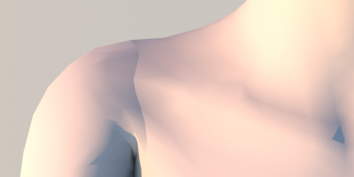

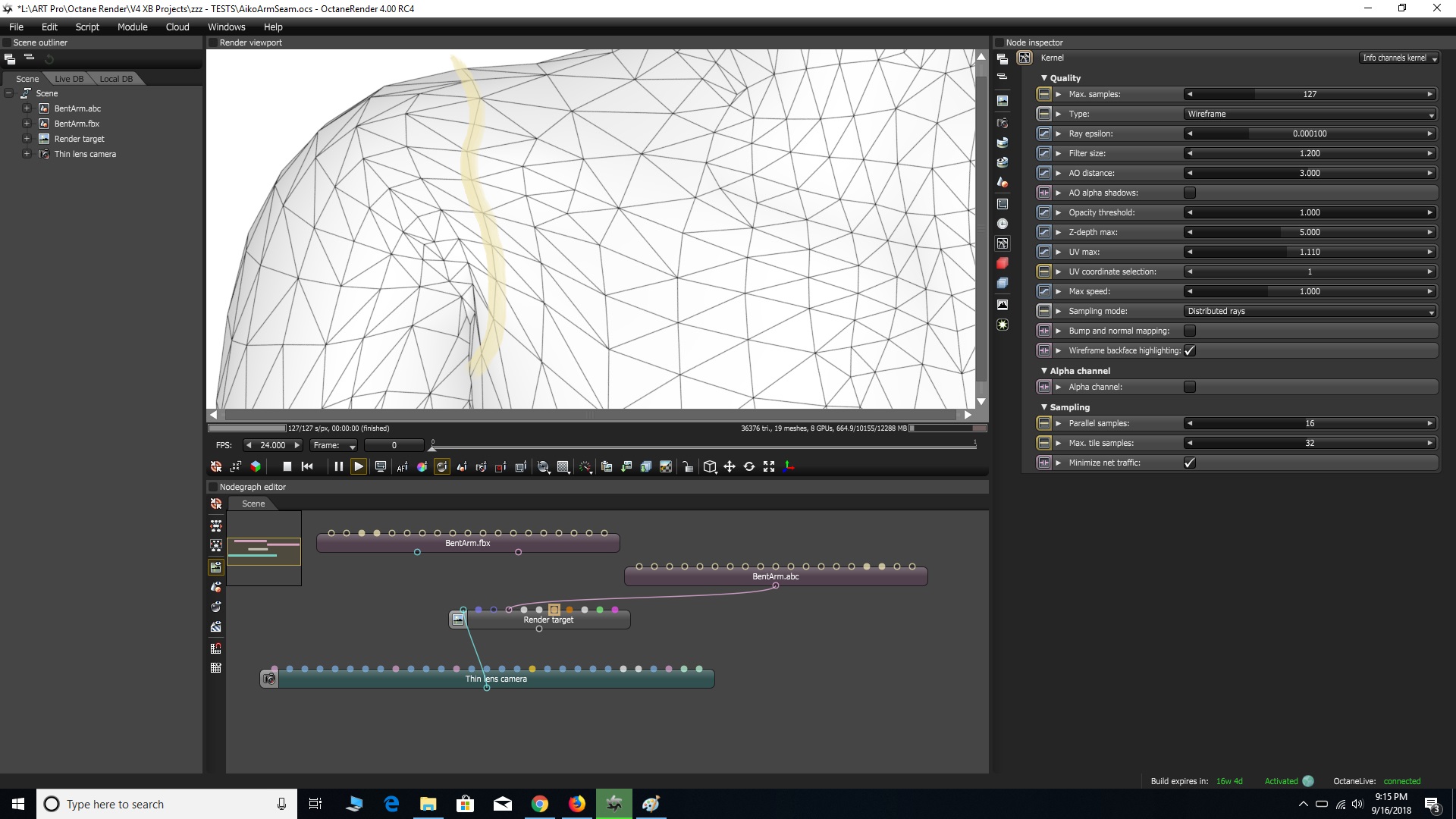

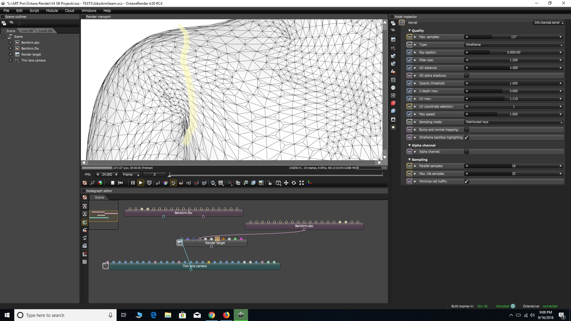

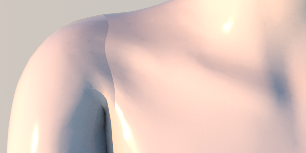

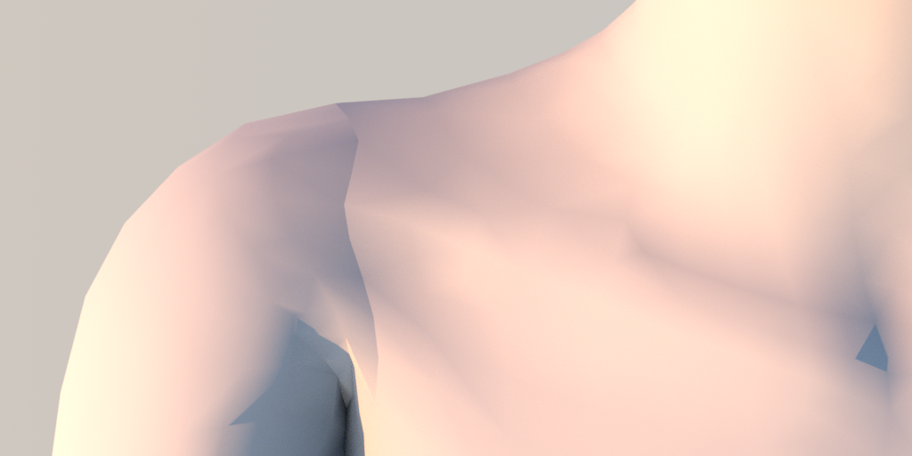

Hi-
Just to give all, both of these scenarios have the issue when checkbox for 'Load Vertex Normals' is off:
SubD off
SubD on
Is there a way I can make Octane calculate Vertex Normals at runtime, I wasn't sure if it is a setting somewhere?
THX!

Notiusweb wrote:
vijay_thirukonda wrote:
Vertex normals from the file are useless when a subdivision is applied on a mesh, so we will have to calculate it on runtime. I guess the problem is the winding order of the body and hands are not same, you can confirm it by rendering the character in the wireframe info channel kernel with wireframe backface highlighting enabled.
Hi-
SubD off
ABCSubD_Off.2.png[/[attachment=2]WireFrame_NoSubD.jpg
SubD on
THX!
If you disable loading of vertex normals, they are calculated during runtime. It definitely looks like the mesh consists of multiple unwelded patches. Could you please send us the scene so we can investigate? Thank you.
Hi-
SubD off
SubD on
THX!
I had a look at the scene you sent to me and the problem is that the body mesh is split into separate mesh objects. Currently there is no way to "fuse" them back to one mesh in Octane. Since the subdivision is done on a per-mesh basis, the subdivided meshes will be discontinuous which becomes very obvious when looking at the sub-divided normals.
This means that the only way to solve the problem is to export the geometry as one mesh object.
