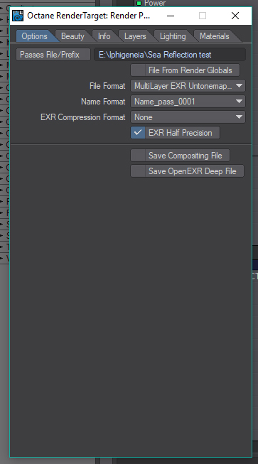

Sorry I'm still not getting this. Please take a look at the attached image and tell me if I have the Render Target set up wrongly - certainly nothing is being saved in the destination folder.

Hmm, I'm not sure if these blank spaces are compatible with the file names. Can you please remove them and try again?

Hi Juanjgon,
I finally have a result and have attached a screenshot of the dialogue box with the settings. After you mentioned that the LW viewer doesn't display the passes I went instead to the designated folder and behold, there they were!
Please could you explain what you meant by "I'm not sure if these blank spaces are compatible with the file names".

You have set as filename prefix "Sea Reflection test" ... I'm not sure if the blank spaces in this prefix could be a problem, perhaps not, but you should use something like "Sea_Reflection_test" (with underscores, not blanks) for example.

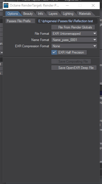

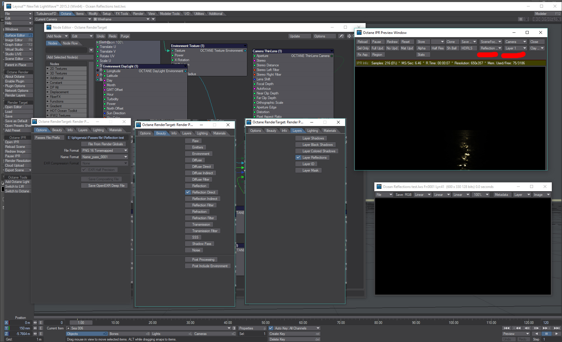

Hi Roentgen,
Here's a screen-grab of my settings. The IPR shows the selection of Reflection and Layer 1 underlined in red prior to F9 render. The LW render window shows nothing of the render. However the desired render placed itself in the Passes File/Prefix directory setup in the first panel. This setup isn't perfect because as well as the file I want I get 2 others that I don't need so I just delete those. Hope this helps. Perhaps Juanjgon can correct my errors?
Well, if you have two or more layers, each one is going to be rendered in an EXR file (one for each defined layer) with all the enabled passes. Currently you can select the passes rendered for each layer, if this is your question.
