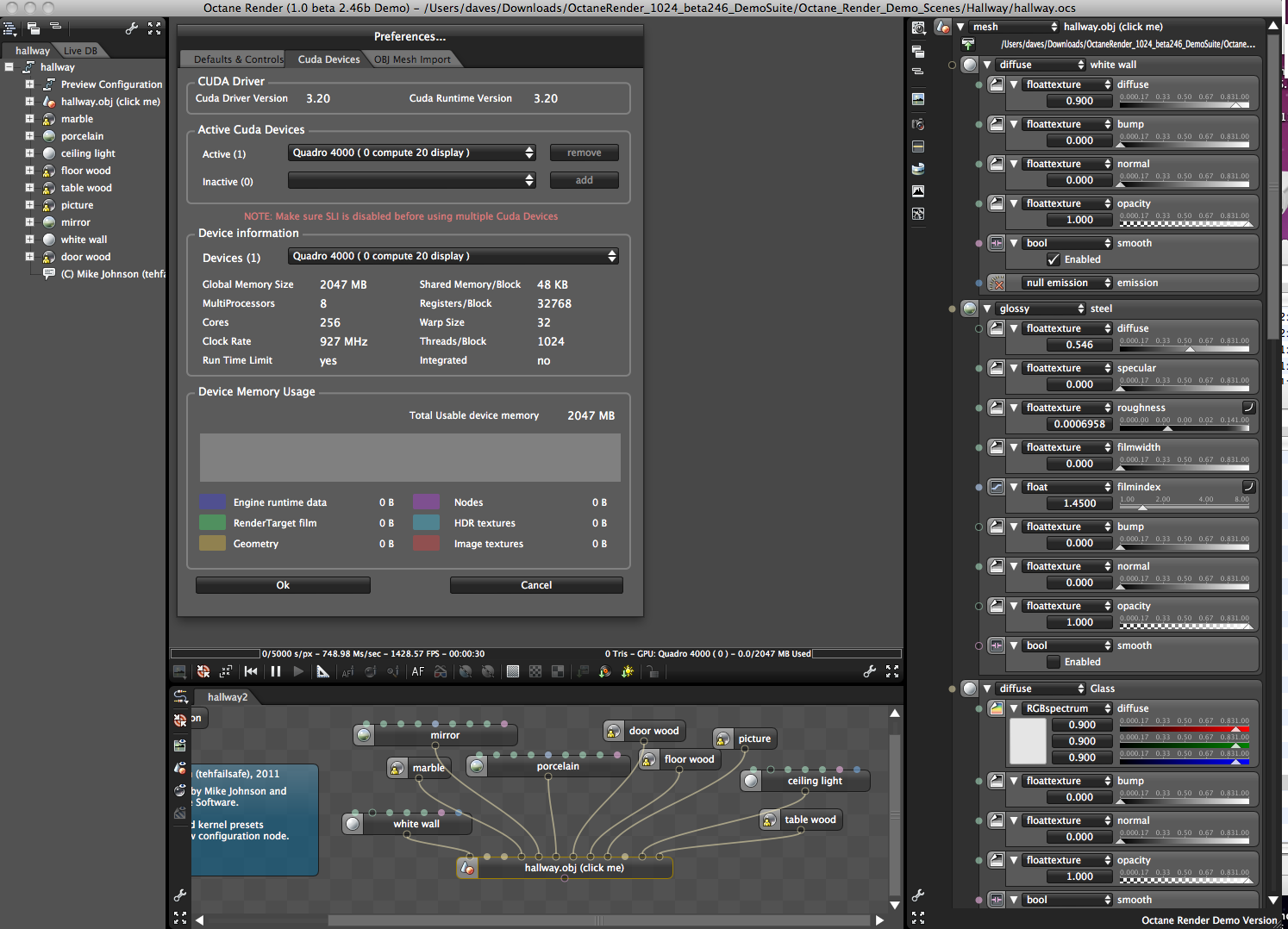

abstrax
Posts: 5513
When you start rendering does it actually increase the samples per pixel? Or does nothing happen. Could you please post a screen shot of the CUDA device information panel under File -> Preferences...?
Thanks,
Marcus
dcardwell
Posts: 12
Joined: Fri May 20, 2011 2:06 pm
Here was my screen. No pixels were drawn.
Windows 7 Pro 64bit, 16 GB Ram, Intel Core I7 3.4GHz, Dual Gtx 580 cards

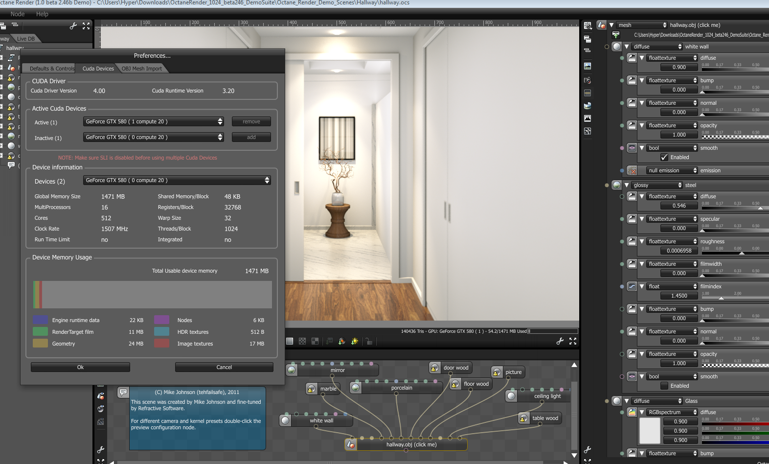

dcardwell
Posts: 12
I could not wait. I went and got Windows 7 machine setup and its blazing fast. 2 Nvidia GTX580 cards in SLI mode. Still testing. Glad its working!
