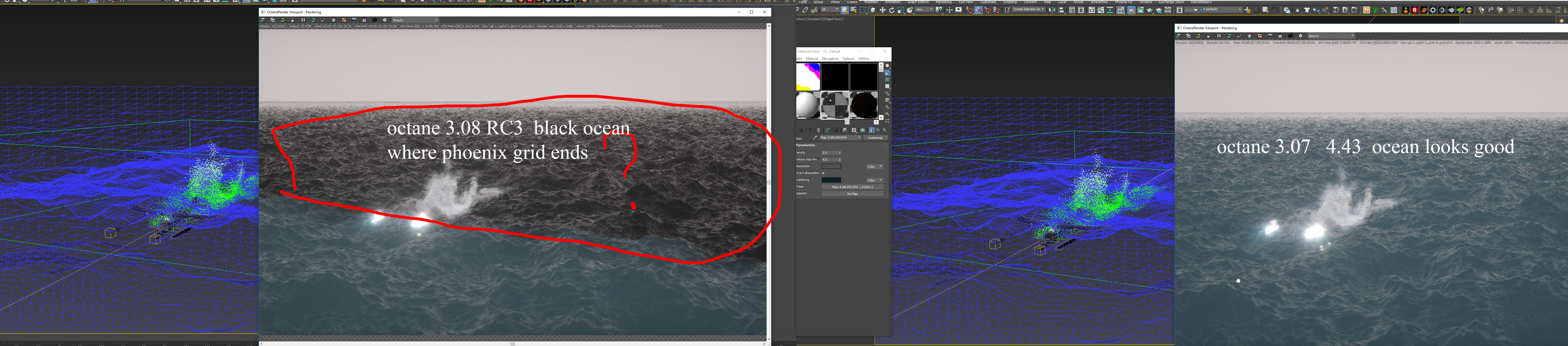

neonZorglub wrote:Hi coilbook,
Thanks for reporting the issue with PhoenixFD. There is indeed a bug in the volume rendering.
That also affect the Octane Volume objects, using VDB files.
A temporary work-around is to add a render pass, for example, add a Diffuse pass in Render settings / Render Element ..
A fix is being working on for the next release.
Thanks!
Thank you Could you also check particles like foam, splash and dark ocean after the grid border to make sure they render correctly
Thanks!
Hi coilbook,
try with RC4, you should solve it.
Regards
Paride

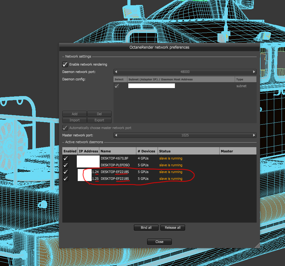

Hi I am not sure if I asked this before but now when my octane viewport is opened one of the slaves quits working and then I open network I see a duplicate of this slave with a different IP. Thanks

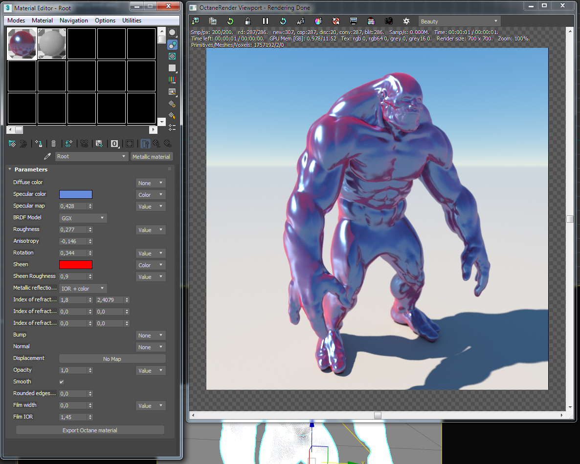

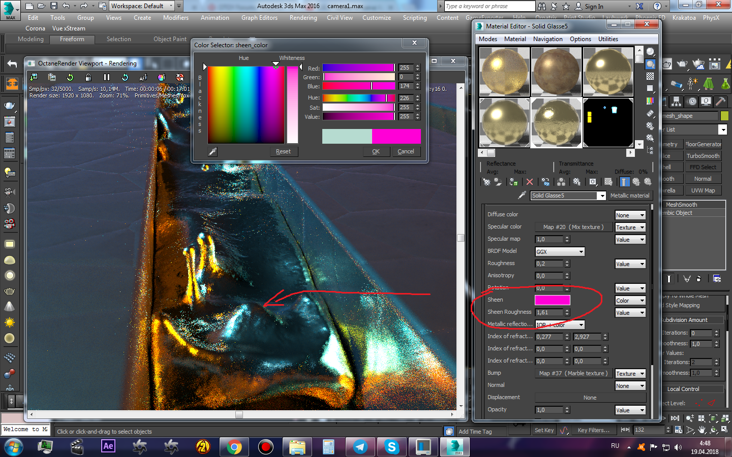

Sheen not work
Win11/msi x79a-gd45 (8d)/ Intel Xeon e5 2690v0/ 64gb DDR3 1866/ Nvidia 4090 Asus TUF/ be quiet! Straight Power 11 1000W 80 Plus Platinum
paride4331
Posts: 3866
Elvissuperstar007 wrote:Sheen not work

coilbook wrote:Hi I am not sure if I asked this before but now when my octane viewport is opened one of the slaves quits working and then I open network I see a duplicate of this slave with a different IP. Thanks
Hi coilbook,
are you using a hub switch in your network or is it connected to something like a router? I had this issue in the past, but not using hub switches.
Has it happened since you use windows 10 and windows 7 together?
Regards
Paride
coilbook
Posts: 3091
Hi coilbook,
Regards
Paride
Hi Paride
all PCs now have windows 10. Master and one of the slaves are connected to the router. Then there is a 50 foot cat7 cable that goes from the router to the switch. Three more slaves are connected to that switch (dlink switch). One of the slaves that connected to the switch is doing this.
