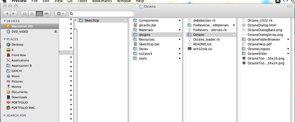

Although the latest one is recommended for the current Octane versions even the older one should work.
Your ../Plugins/Octane/ folder should also contain the older file "Octane_1022.rb" as well as the newer one "Octane/Octane_1024.rb" [I can't see in your screen-shot as the window is scrolled down]. If not install the _1022 version then the _1024 version over it - then you will have both .rb files.
The file inside ../Plugins/ called "Octane_loader.rb" loads a particular version.
To load the latest version it says
#load "Octane/Octane_1022.rb"
load "Octane/Octane_1024.rb"
with the earlier version disabled by the leading '#'.
To let the older version load you swap the '#' thus
#load "Octane/Octane_1024.rb"
Now _1022 will load/run after a restart.
If you now get that to open OK then something in the newer version of the rb file is incorrect - although I can't see what it might be
If it still fails you can try reinstalling _1022 and overwriting all files - that version will now load/run on a restart.
If it opens OK then the error is in the newer versions of the dialog's file [html/js/css etc] - although again I can't see what it might be
At least we then have clues about from where the error is emanating...
Let me know the outcome...
