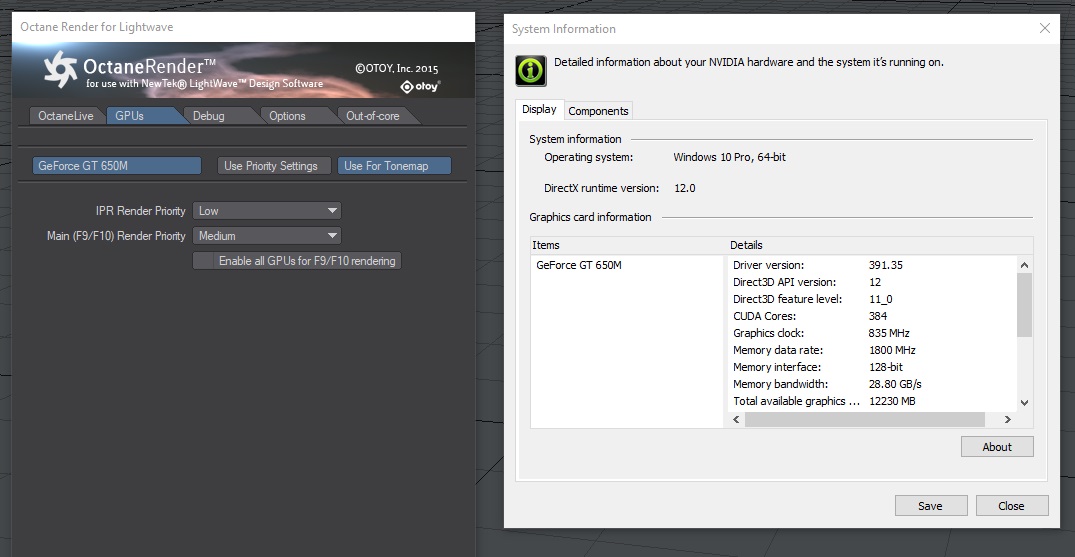

But what NVIDIA drivers version do you have installed on your system? Right-click on the desktop and open the NVIDIA control panel. In it, you have a system information tool to check the current drivers version.
I've just updated my old laptop with the latest ones available, and the current 3.08.0.9 plugin seems to work fine with them.

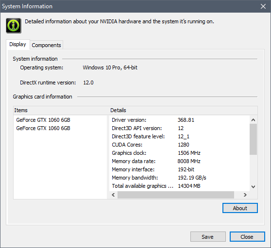

lightvu
Posts: 94
Joined: Mon Nov 20, 2017 6:49 pm
juanjgon
Posts: 8867
Location: Spain
Well, yes, these drivers are old. You need to update them to work with Octane 3.08 ...
Thanks,
-Juanjo
lightvu
Posts: 94
:lol:
I don't understand Juanjgon. I downloaded the 'latest version' from NVIDIA last week, right before I made this post.
juanjgon
Posts: 8867
Location: Spain
Hmm, but have you installed them? Download the file is not enough ;)
-Juanjo
lightvu
Posts: 94
lol
Yes good sir they were installed. Maybe I took the wrong link, because I can now see that what I downloaded was an old version, I now have the version of NVIDIA drivers that you do.
I will try this first thing in the morning - thank you for all your help and patience with me on this one :)
Cheers!
