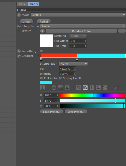

Dear aoktar and dear community.
Maybe I am doing something wrong. How can I limit the colors of the gradient node to straight colors without interpolation? Setting the interpolation to "None" does not work. Octane still interpolates between the nodes.
Posts: 16068
Location: Türkiye
momade wrote:Dear aoktar and dear community.
You should use "interpolation" on top not c4d's parameter.
The attachment Capture.PNG is no longer available
solution option
solution option
2018-04-03 00.45.20.png (3.71 KiB) Viewed 5060 times
Posts: 16068
Location: Türkiye
Wrong usage! Why don't you just use this? Invisible option?

fleshs
Posts: 7
Joined: Sun May 05, 2013 7:03 pm
aoktar wrote:
:roll: Thanks!
