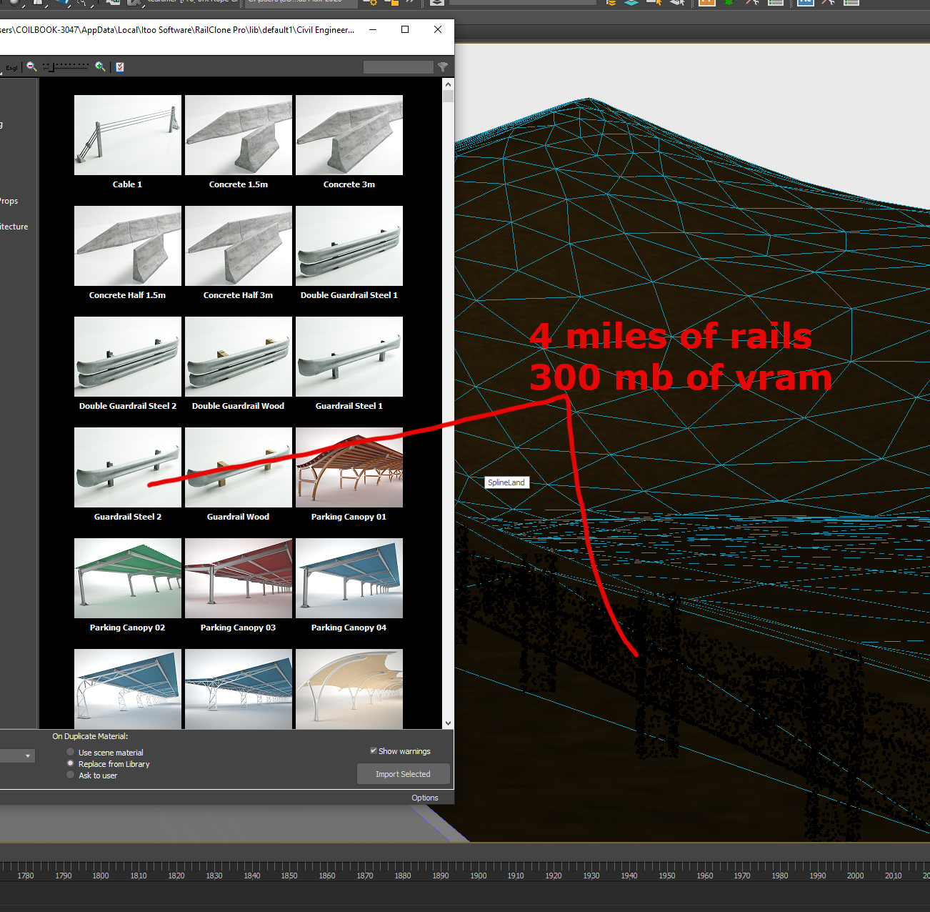

It doesn't work for me. Rail Clone uses a lot of vram like instance doesnt work the way it works in itoo forest. We created highway rail guards 4 miles long and it uses 300 mb of vram. Too much for instanced objects. Can you look at it? Thanks

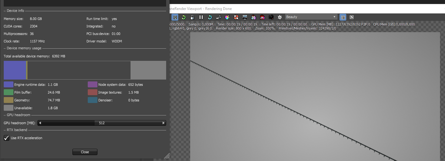

I had a 4 mile rail guard, it eats about 74 Mb.
Do I something different from you?
Regards
Paride
