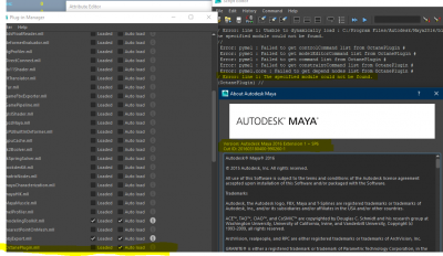

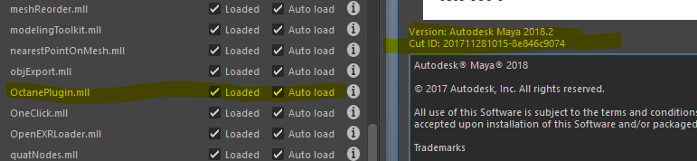

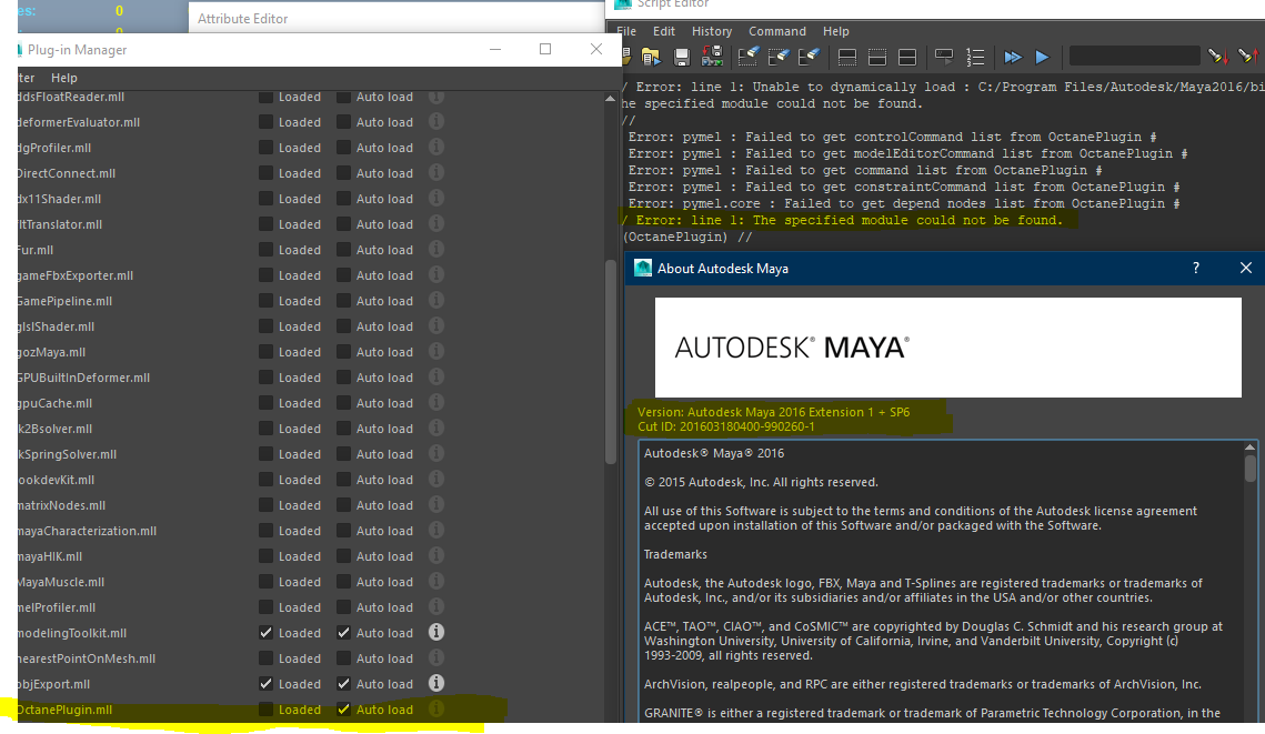

I just test in maya 2016
It cant not load plugin !!!
2016 not work
2016 not work
2018_ work
2018_ work

zurakan wrote:I just test in maya 2016
Hi, Zurakan,
Thanks for reporting this. We were able to reproduce as soon as we update Maya 2016 to SP 6.
Is it possible to go back to previous stable release while we are looking into this?
Cheers
Kind Regards
bk3d
