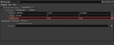

Oops, you are right. It seems a problem related to the new Houdini 16.5 plugin version. In the Houdini 15.5 and 16.0 plugins builds the Octane light scale seems to work fine. I'll take a look at this issue to fix it for the next build.
Thanks for reporting this issue!
-Juanjo
