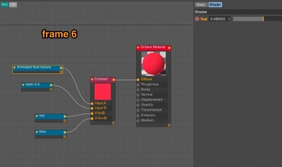

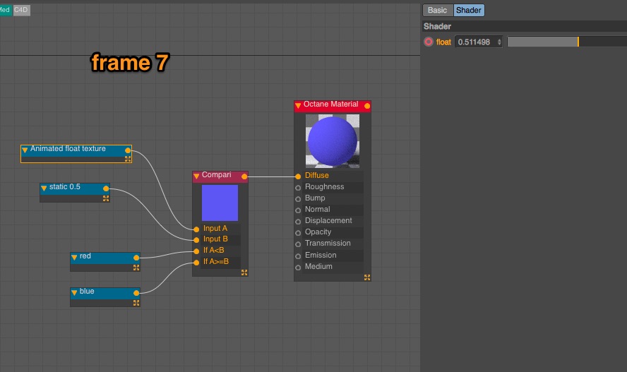

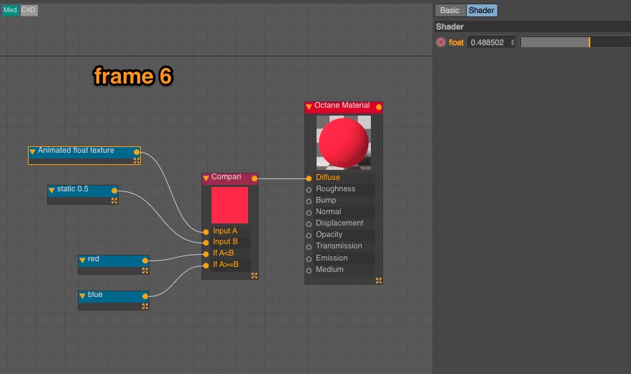

Hi Thanulee,
not sure if this is a practical example for you, but it shows the mechanics of the node.
A is an animated float texture from 0.4 to 0.6 over 13 frames
B is a static float at 0.5
if A is less than B - diffuse is red
if A is greater than or equal to B - diffuse is blue
A float value changes over time, so:
on frame 6 it's 0.488502 (less than 0.5) stays red
on frame 7 it's 0.511498 (greater than 0.5) now the color changes.
compare.c4d.zip
(75.46 KiB) Downloaded 172 times
