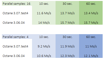

I tried to recreate that scenario and wouldn't you know it...I couldn't. I re-launched Octane and the problem didn't occur again. I didn't mention that first that happened while Vimeo was full-screen on my second monitor and I run a batch render on the first one (didn't know if that mattered and most certainly non of that would matter after the relaunch).
Anyway, here are the observations I made while I was trying to recreate the original scenario.

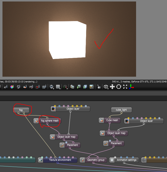

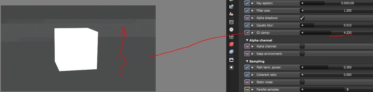

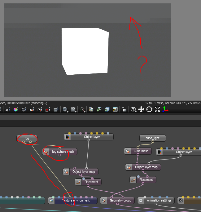

Hey guys, I think something about the environment medium is broken. I don't use it a lot so its possible I may be doing something wrong.
I have an orbx here with a scatter node plugged into an inverted sphere (the old fog trick), and also plugged into the environment medium.
The inverted sphere renders ok, but if I remove the sphere (disconnect "fog sphere mesh" from "object layer map"), I get no fog, and some kind of render error.
If I edit some of the scene settings, (eg. gi clamp), these incorrect rendered areas move around the screen too.
env_medium_broken.orbx
(171.53 KiB) Downloaded 257 times
Win10 Pro / Ryzen 5950X / 128GB / RTX 4090 / MODO
"I am the resurrection, and the life: he that believeth in me, though he were dead, yet shall he live" - Jesus Christ
Posts: 10661
Hi funk,
thank you for the report.
There was an issue in this version with Environment node, and it has been already fixed for the next version.
Happy Rendering,
ciao beppe

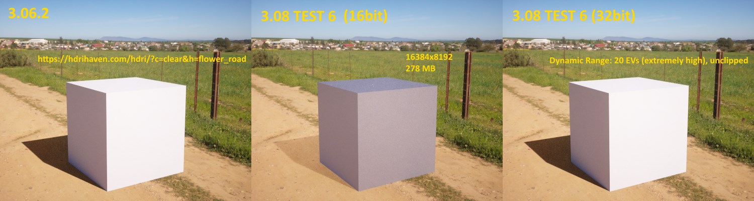

Right now I've found the case, when 16 bits (for environment HDRI) is not enough:
It took me a while to find the cause... the first suspects were the extended Imager settings in 3.08. :)
That scene issue seems to appear when environment HDRI have large dynamic range (Here the https://hdrihaven.com/hdri/?c=clear&h=flower_road was used, 16384x8192 version).
P.S. It happens in Octane 3.08 TEST 6, so in this thread it's a bit offtopic :roll:
