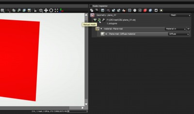

Posts: 10621
Hi jorgensen,
in the Node inspector of the geometry node, you can load a new file, or reload the same if updated:
Happy Rendering,
ciao beppe
