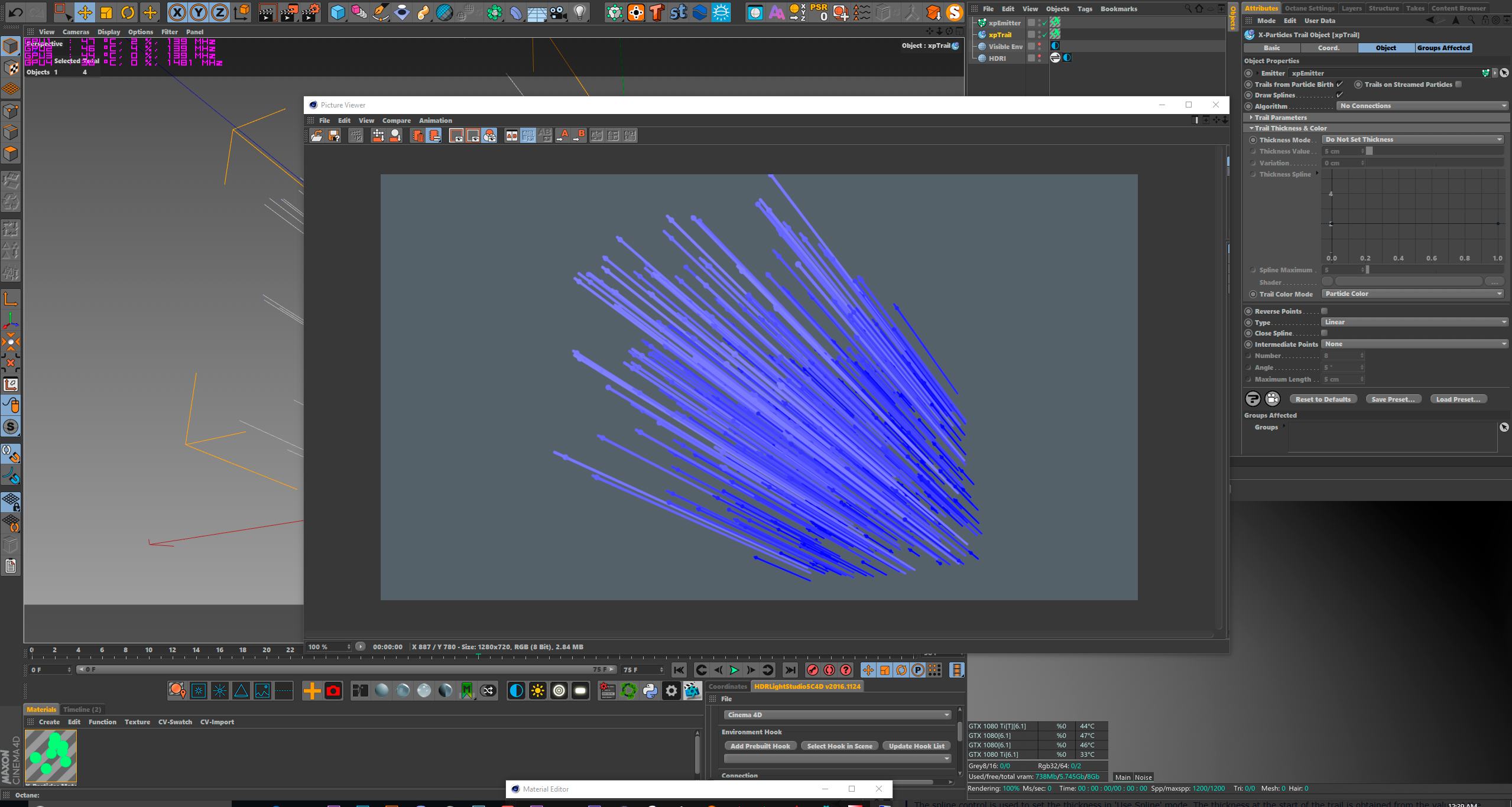

Another question regarding trails:
Is there a way to use the trails data like age and speed? or does it only apply to particles? i tried dropping the trails object into the instance color node but it doest effect the trail colors as it does on particles
Best,
Guy

Studio21
Posts: 212
Joined: Wed Nov 16, 2016 11:14 am
Maybe this will explain better what i mean.
Trails that can get the same color as particles based on their age, speed etc
Xp trails color by age - standard renderer
