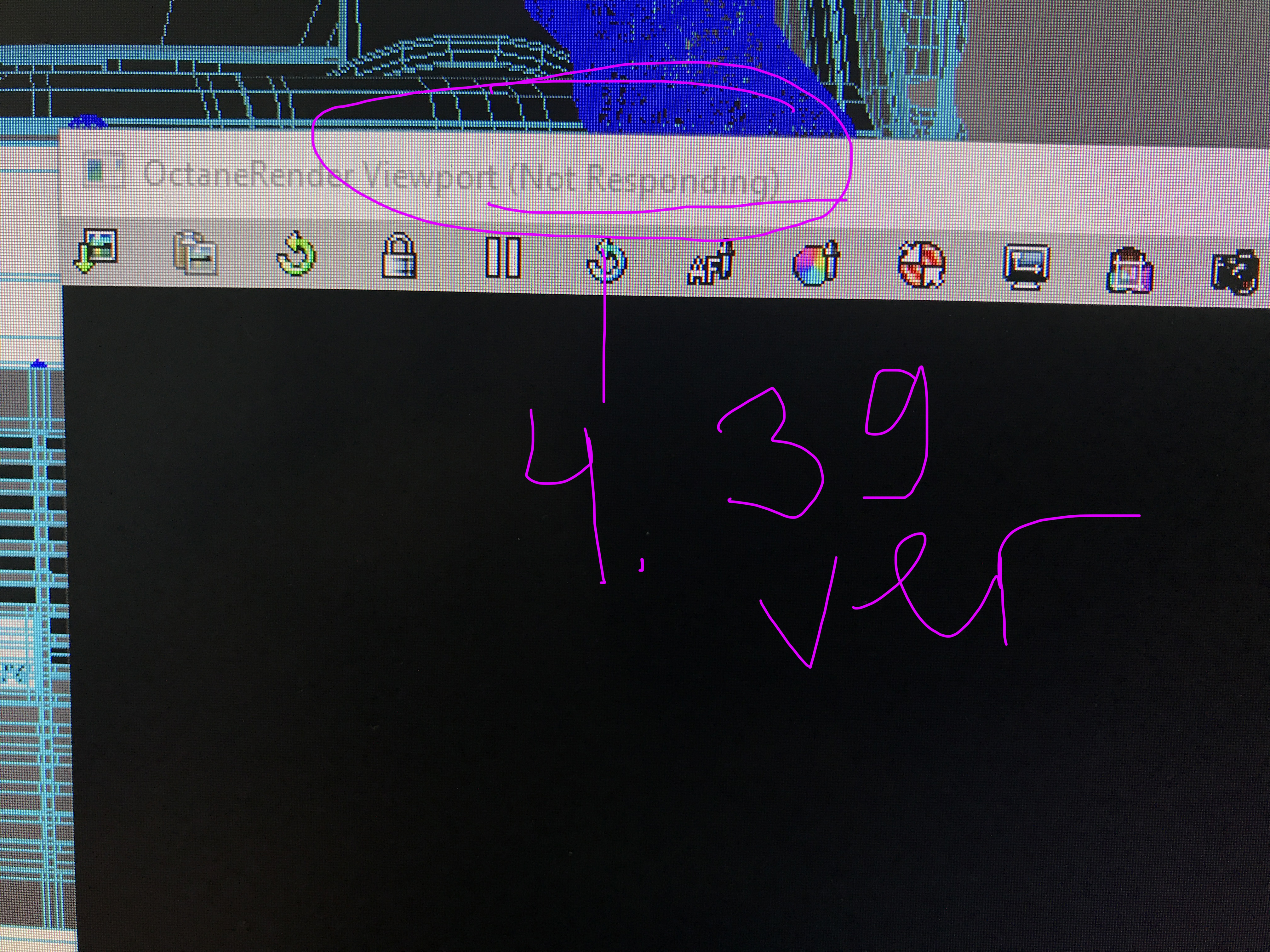

4.39 fixed phoenix mb !
Your scene works fine so there is something in our scenes that make new version very slow.
Version 4.38 - 32 seconds to open octane viewport
Version 4.39 - 9 min 20 seconds seconds to open octane viewport
I just emailed you my scene so there is definitely a bug in 4.39 that makes old scenes open very very slow making rendering 10 times slower per frame
i attached the video with 4.38 version and how fast it is and 4.39 usually stuck with mo response
438 version .mp4
(4.91 MiB) Downloaded 3693 times

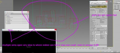

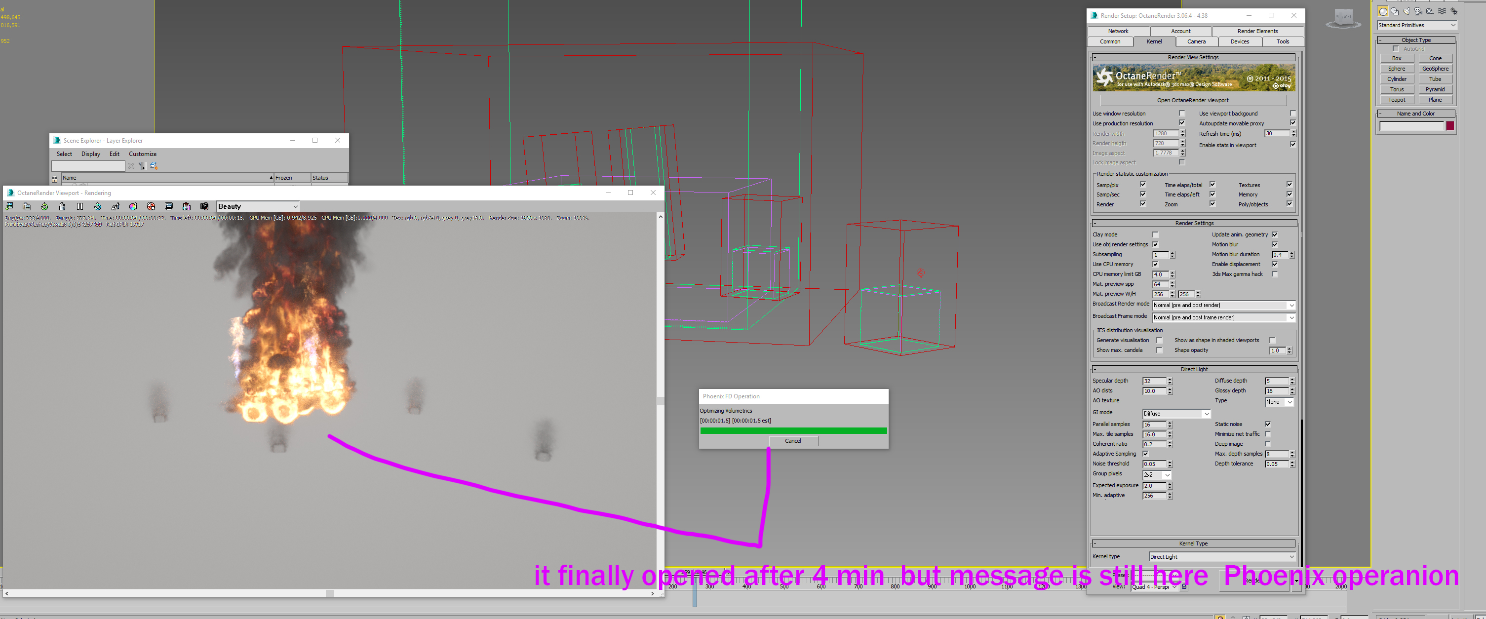

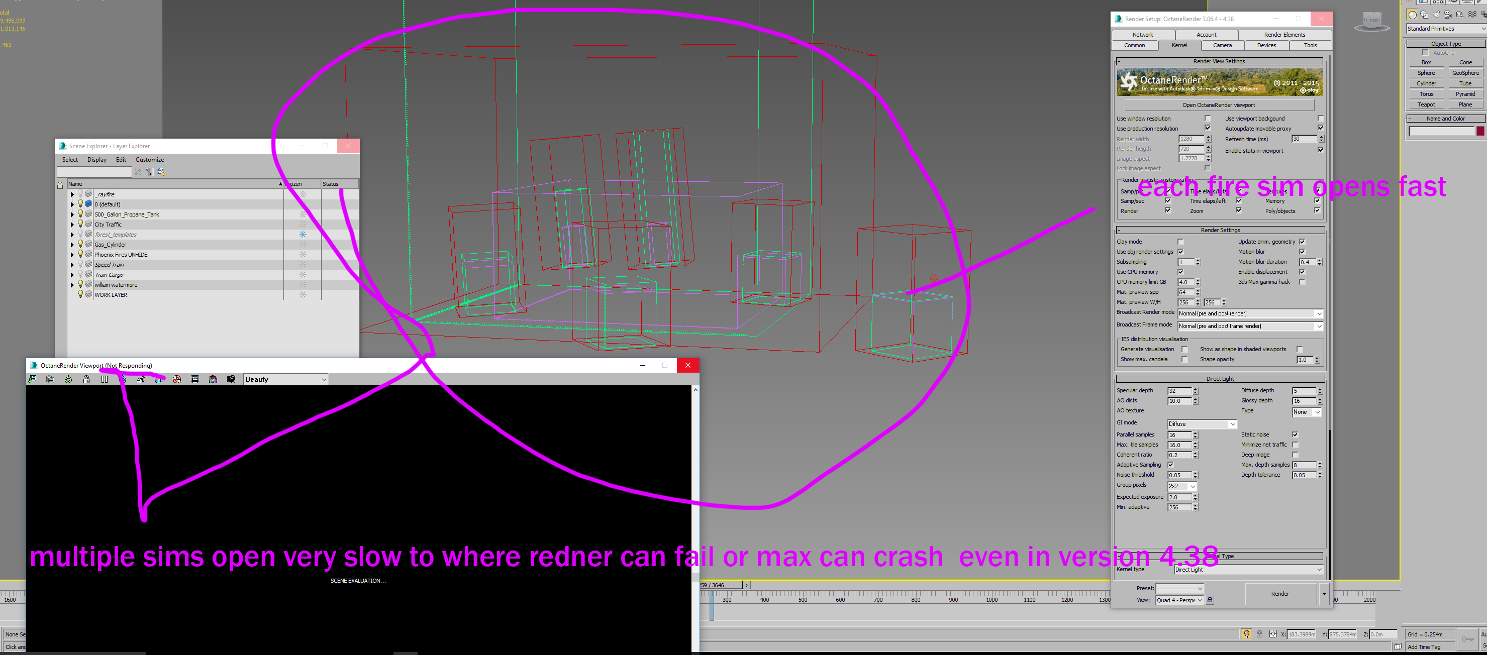

coilbook
Posts: 3176
There seems to be a bug if you have multiple phoenux fd grids for multiple fires
it takes a long time to open octane viewport with multiple sims if it can even open. But each sim opens in less than 3-4 seconds
