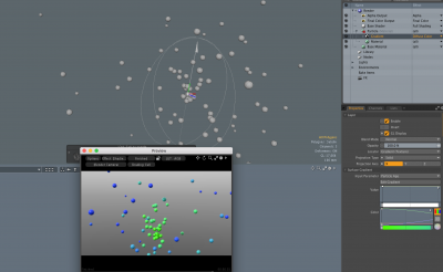

That could be very useful! I want to achieve something like this:
The colour of the Instance is based on the particle ID or the age of the particle. It would be great if we could do this in Octane.
Particle_ID.lxo.zip
(145.27 KiB) Downloaded 257 times
face_off
Posts: 15799
Location: Adelaide, Australia
Hi - this has now been implemented in the plugin, and will be available in the next release.
