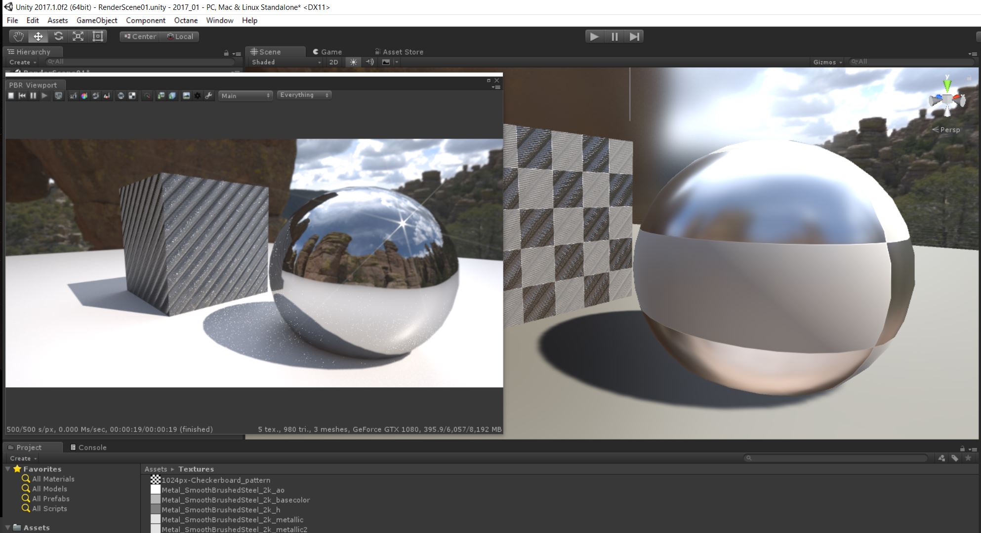

Actually, the gloss maps aren't working at all. Here's a checker texture in the metalness alpha channel to illustrate.
