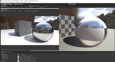

adamnerva
Posts: 112
Joined: Mon Apr 27, 2015 9:01 pm
No gloss maps in Octane for Unity
Actually, the gloss maps aren't working at all. Here's a checker texture in the metalness alpha channel to illustrate.
