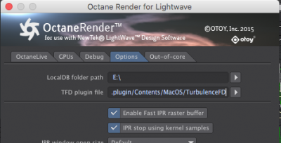

I can confirm that TFD 1427 works fine with the upcoming LightWave plugin build that I'll release later this week. Be aware that in the Octane plugin options panel, the path to the TFD plugin must be the full path to the "TurbulenceFD" library available inside the TFD .plugin container.
