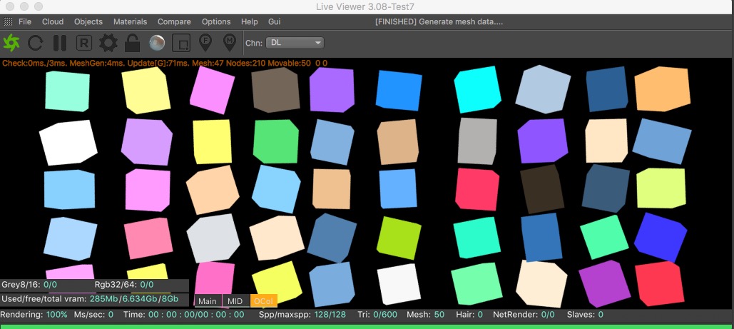

the MaterialID works with a random function, so the colors can change.
To have a more solid control over the mat id , you can use the Object layer color pass instead.

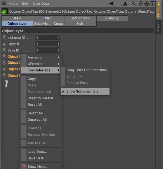

assign an object tag to all the objects or group of objects, then, with all the tag selected, in the Object layer tab, you need to right click on the Object color name, and choose User interface/Show sub channels:

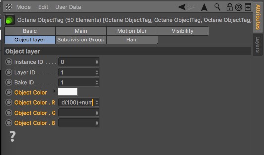

then type rnd(100)+num in all the three color fields to have different colors that do not change:

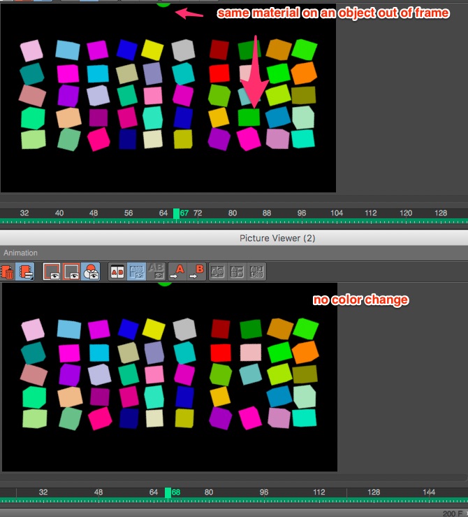

Not possible without ruin a lot of things in my side. You should use all materials to keep order as a workaround. Put unvisible object's material to an object which is out of view.
Sorry!
niestudio
Posts: 265
Joined: Fri Aug 21, 2015 10:03 pm
Thanks Ahmet, thats and interesting and easy workaround.
I suppose you could add all materials to 1 small polygon off camera or hidden with octane visibility.
works well in my quick test.
